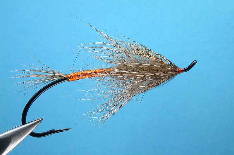

Steelhead Pat
Hook: Tiemco 202SP #6
Thread: Danville Flymaster 6/0, hot orange
Hackle: Partridge, brown
Rib: Tinsel, gold oval
Tail: Partridge, brown - tied short
Abdomen: Floss, orange
Thorax: Australian possum; partridge, grey; Australian possum
Note: Brush out the Australian possum with a velcro brush to form a shroud
Video here - please view in HD, if able:
http://www.youtube.com/watch?v=9JXgib-lIyY

Very neat tie Hans.
Is it aimed soley at Steelhead or can it be used as a Salmon or large Trout pattern?
Does it represent a small baitfish, or just something to provoke a strike from an angry Steelhead?
Really like the double hackle method, divided by the thorax dubbing. Most double hackle Steelhead patterns I have seen have both hackles wrapped at the front.

Jeff,Mataura mayfly wrote:Very neat tie Hans.
This is a pattern originated by Loren Williams in New York state for fishing the Great Lakes steelhead coming into the streams for spawning. He does tie it in smaller sizes, and a bit sparser, as a wingless wet for 'plain' trout also.
What does it represent? Dunno, but for Loren (a fishing guide) this is his go-to pattern
Here is a link to an article you might find interesting. It fits in quite well with this here forum topics:
http://www.hatchesmagazine.com/page/may2006/178
Cheers,
Hans W

Beautiful fly--that's literally the first pattern I ever bookmarked.
- Posts: 13345
Re: video - Steelhead Pat
Somehow I missed this one. Hans, this is my kinda fly! Kudos!
Nice tie there Hans. Not often we see a secondary hackle in the middle of an extended thorax like this.

Mostly because there isn't onegingerdun wrote:Nice tie there Hans. Not often we see a secondary hackle in the middle of an extended thorax like this.
