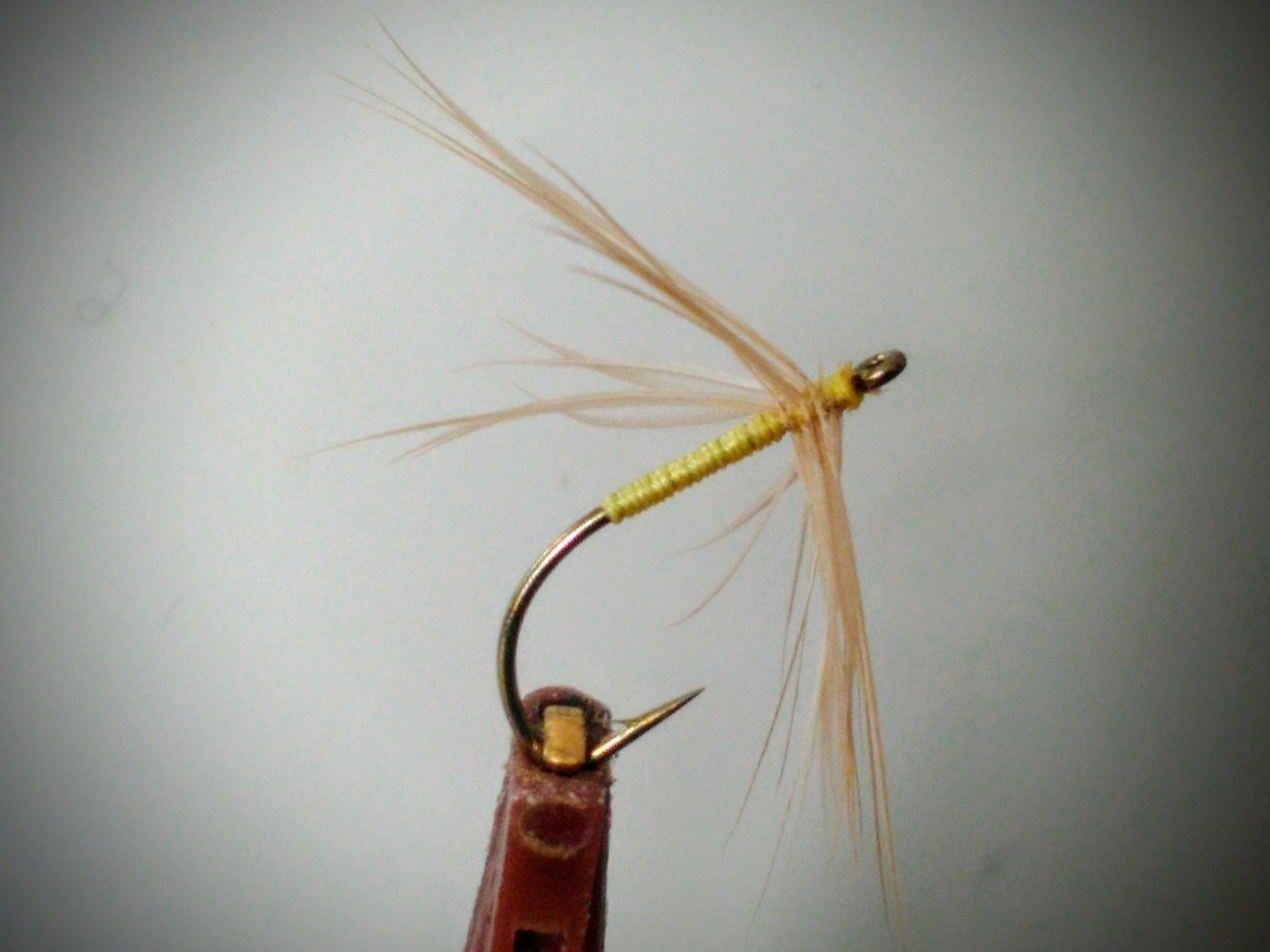

Thought the outside small covet feather of an American woodcock had a nice beige tint and thought it might sub well for a Dotterel feather but I was wrong. The barring mark come out too pronounced on the closeup. Oh well.
Hook. ...... Tiemco102Y sz 17
Thread ..... Pearsall’s gossamer yellow
Hackle ..... Outside covert feather of an Amer. Woodcock

I think it's generally agreed that we are all on the perennial lookout for Dotterel substitutes and on this one, you did good! I don't think that our finny friends are that picky although, they are legendary for selectivity! Let the search continue! Are you finding other good substitutes on other species of birds?

The accepted substitute since Pritt's time has been the inner covert feather from a starling. My guess is that even most of the original Dotterel flies that have survived the ravages of time and moth are actually dressed with this feather. Placed side by side, the two feathers are closer than most other suggested substitutes.
Skues described the color as a "cream in coffee color with lots of cream." There is no barring on a Dotterel feather.

Well, here's some genuine Dotterel, framed by Corncrake (top) and Nightjar (bottom). These are iphone snaps, as a quick reply--I;d have to set up the lightbox to take better photos. There's very little barring on a dotterel, as John said, it's more a matter of shading.

There are some feathers on the Dotterel that look similar to some Woodcock feather--they both have this orangeish-tan tint--close to the coffee-and-cream John mentions. But it's going to vary from bird-to-bird, from part-of-the-bird to part-of-the bird--so it's hard to generalize. There's also seasonal variation in a lot of the plumage as well--.
That's just talking about color--feather structure is another part of the equation....
