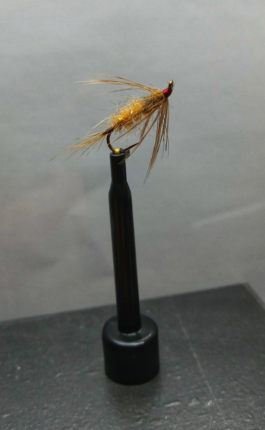

The RFSN has been one of my favorite flies since long before Mr. Whitlock passed. It's one of those flies that 10 different people can tie the exact same thing and come up with 10 different looking flies and with everyone posting them lately that's become even more apparent. I sat down to tie a few and figured I might try something just a little different.....
Hook-12 1XL
Tail- guard hair
Abdomen- half squirrel belly, half SLF spun on copper colored GSP
rib- sybai flat wire, gold, small
Thorax- squirrel back under fur 75% gray 25% orange
Hackle- speckled ginger hen, one side stripped and wound trough thorax flymph style but it's very sparse and hard to tell
Thread- claret utc
Hook-12 1XL
Tail- guard hair
Thread- claret utc

Very nicely executed. Perhaps a Whitlock-themed fly swap is in our future!

Wow! I think I'm love...with this beautiful pattern of yours! Why didn't I think of this before now? These have to get added to my RFSH box and then off to the waters edge for field testing! Your pattern recipe shows great care in bringing together the materials and your tying is absolutely spot on in all respects! It looks great! Thank you for creating such a great looking pattern! Dave would be very proud!

@DOUGSDEN Wow.....I'm speechless at your kind words. I lurked around this forum for a long time trying to learn the ropes before I had the guts to join and post any of my work. Getting praised by a staple of the community like yourself means a lot to me. I would be in for a fly swat too! Dave had a ton of really cool patterns but most only knew him for his RFSN and only for its most modern version. He actually had maybe 10 or so versions of the same fly over the years constantly evolving with the new materials and trends. I prefer to actually use a squirrel skin and not just SLF so I thought it would lend itself nicely to flymph form. I will say tho the red squirrel SLF is excellent and about the only synthetic material I use. Definitely tie some up and post some pictures!!

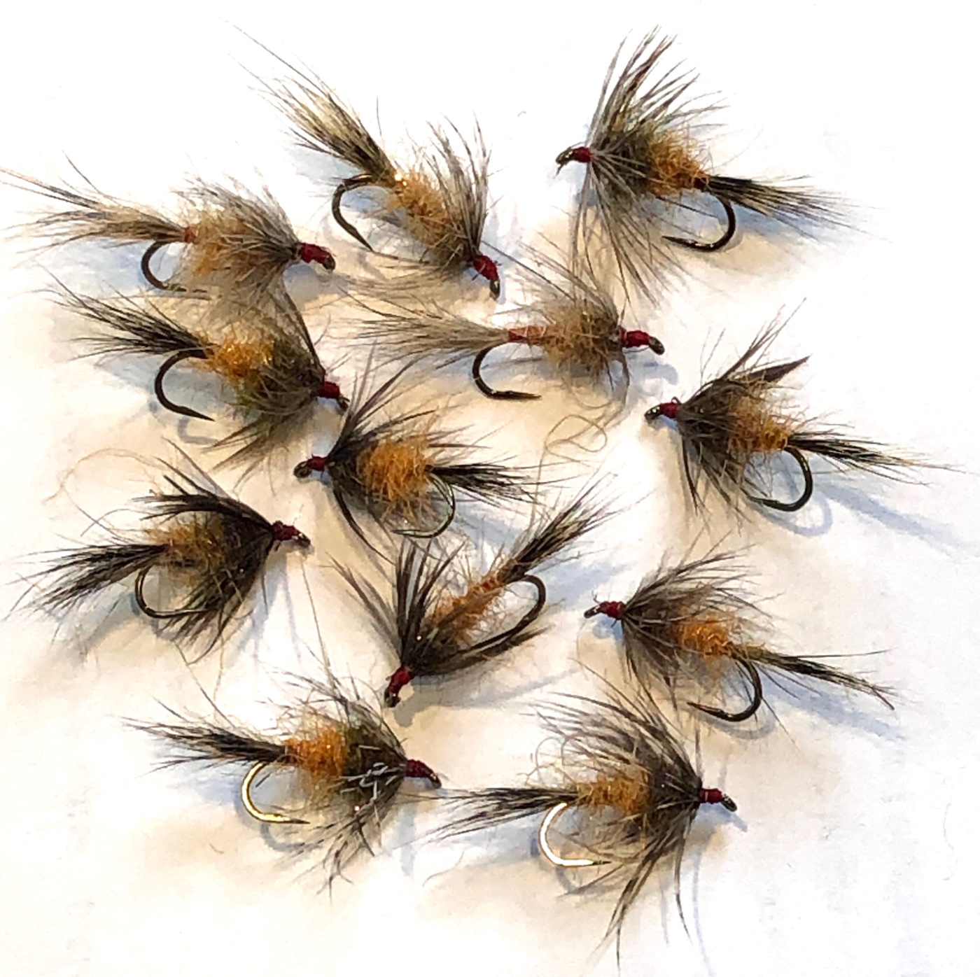

Several months ago, I tied a few of the RFS nymph and gave away most of them to some friends. i think I have only 3 or 4 left. Needless to say, there will be more in my fly box before my next fishing trip.

Delicious looking Bob! Your patterns are fantastic! I love the way you have "adjusted" the hackle (light, dark) and the wonderful effect it gives! I can see any of these anchored in the scissors of a huge trout! Please verify this with pictures....lots of pictures!
