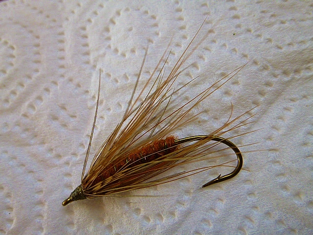

Bird's Carey
Hook: #6 TMC 200R
Thread: Olive Uni
Rib: Olive hot wire - medium
Body: Mottled chestnut/brown wool yarn taken from a Oaxacan blanket (brown/olive heather is good)
Hackle: One brown & one 'green' pheasant rump hackle - the softer church-window feathers taken from just above the rump - one turn of each, trained back against the body - & finish with a full, tapered head
A riff on the old Carey Special, an indigenous pattern native to B.C., meant to simulate dragonfly nymphs. This version in a #10 covers the big Traveling Sedge of PNW lakes as well. The pattern travels well, & is a good lake fly everywhere I've used it.

The foto is crappy & not showing the greens in the mix very well, sorry...
