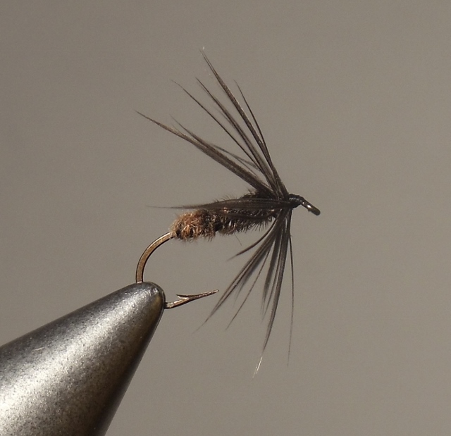

Martin, an excellent question. I've actually spent some time today looking over dozens of marks flies and remembering what an impact he made on my pursuit of these flies and my deep appreciation for Leisenring. Mark was one of finest tiers I've met. I didn't realize he has substituted the turkey tail for the crow herl. It's a brilliant shade of black/brown with a very slightly longer herl knap, if that's a description you'll understand. It's a fuller body but it would be very easy to understand making the substitution if a turkey tail were closer in reach than the crow. I too love this pattern very much.
Bill, that's an excellent pic to illustrate the area in question. Very recently Bill Shuck took advantage of this section by tying the Swedish soft-hackle pattern (starts with a K, somebody help me out) and used the tan portion at top to create a beautiful tan tag which changes abruptly to the deep brown/black body herl. Exceptional.
Knekestorparen

Bill, that's the bomb. Knekestorparen. That's the one. I love that pattern and did you go the next step making the original pattern into a twisted body with the brown silk? What can a guy say, just spot on. Beautiful.
Steve, like you I've carried my version of Leisenring's BG for a number of years. Probably less than forty, more like 6-7, but still wouldn't want to be without it. It's my go-to dark fly when that's what's needed. Looks like I've some options to fool with. What I like about the crow is how slender the profile remains, as pheasant and turkey create a more plush texture, but them many of my favorite softies are tied with turkey, pheasant or goose. Now to the vise to put some black pheasant, dark turkey and turkey twist Knekestorparen's together. I'm not old enough to have settled on a pattern and you fellas don't make it any easier. Now more variations are in order. :D

I was remiss in not mentioning when I posted the above Knekestorparen photo that my inspiration to tie this Gunnar Johnson pattern came from OC Steve, whose wife is Swedish and who can actually pronounce the name properly ;) . And, if memory serves me, ScottP has also posted his version of this pattern in recent months.

It might be fair to the Knekestorparen's originator to say that the original pattern actually calls for a mottled secondary with buff tip, not the black-banded primary shown here. The body of Knekestorparen is mottled brown with a buff tip.
