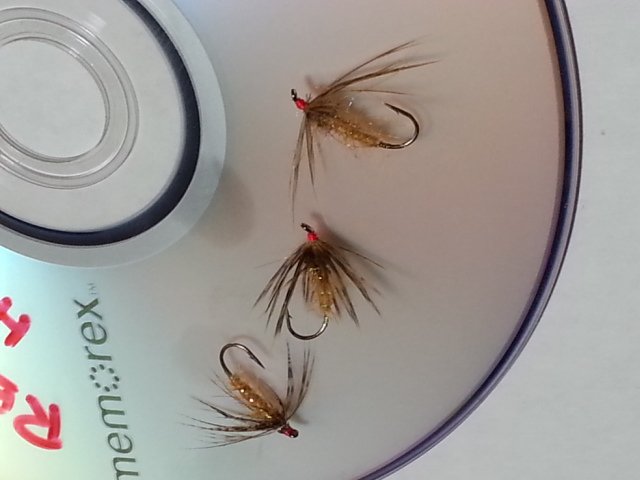

Hi Guys,
I wanted to share some RFSH Wets (the Nymphs will be coming soon!). They are a blast to tie and so deady up on top in the surface film and just below it! These are deviations from the general nymph patterns. I hope you like them!
half dozen
half dozen

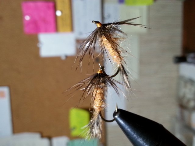

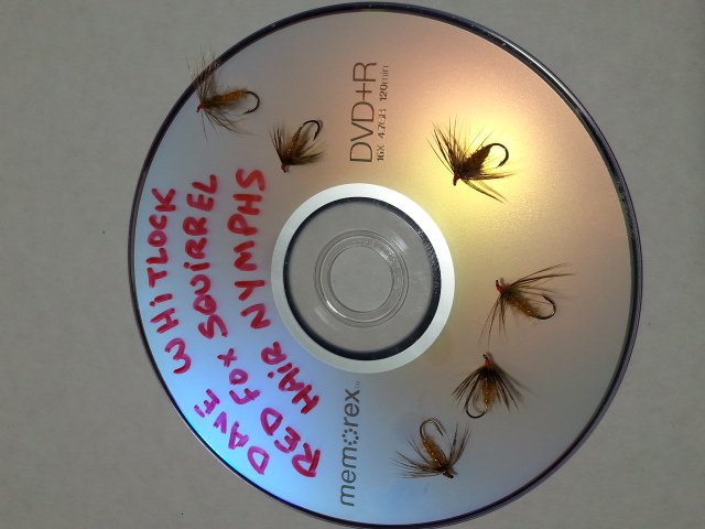

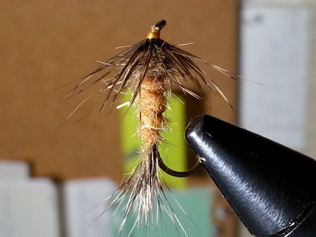

Dave,
I found my CD/DVD and watched it (enjoyably! I forgot how fantastic it is!) and came up with some interesting ratios! Here they are!
The abdomen (belly fur) to orange antron is a 50/50 mix! This seems right. I know that it surely brightens the belly fur up when mixed! The same goes for the thorax (back fur), a 50/50 mix.
Also, the antron needs cut to appx. 1/2" long or else it winds itself around the spindle of your coffee grinder/fur blender! When the fur and the antron come together, it is magic!
Below, are a couple of size 10 nymphs (with lead wire wound around the hook shank) that I just tied! Let me know what you think!
From a Nympher as well as a Flympher,
Dave Whitlocks incredible pattern
A pair of size 10's....huge!
Re: Red Fox Squirrel Hair Nymph
Posted: Wed Feb 20, 2019 7:38 pm
I forgot some other interesting stats! The abdomen is 2/3rds the length of the body. The thorax is 1/3 the length of the body. The tail length is approx. 1/2 the body length! I find that this is a bit long for my liking. I sometimes substitute some partridge fibers and make them a tad shorter. It really dresses things up. Sorry Dave W.!

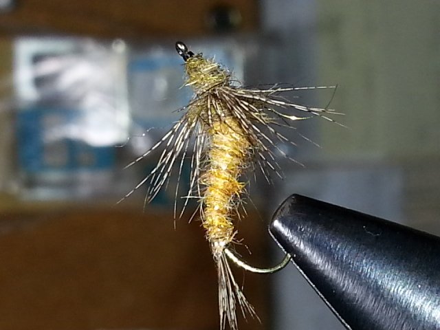

Hi Fellows & Ladies!
More junk from my trunk. I have marching headlong into Red Fox Squirrel Hair Nymphs! The latest ones have been tied on swimming nymph hooks. These are my favorite! I have to admit that in the two patterns that I tied and posted earlier (above) without the furry and fuzzy head! Since then, they've had this important appendage!
Enjoy,
Finally, a full box!

Awesome work Doug - that pattern will imitate many many different things !

Very nice!
Those "Fuzzy Heads" fished in riffles during a Green Drake hatch would be a blast.
Well done Mr. Dougsden.
