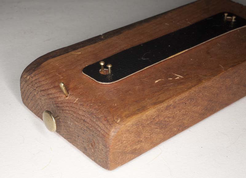

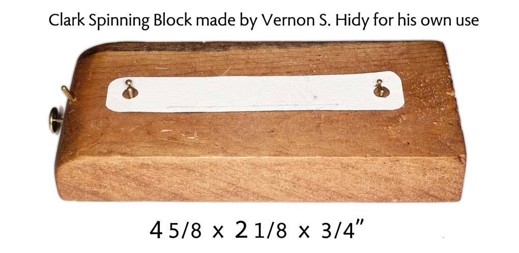

Dick Clark who invented the spinning block was a fishing companion of Jim Leisenring and Vernon S. "Pete" Hidy. Both Dick and Pete learned to spin bodies from Big Jim. Jim spun the bodies on his pants leg, which Dick didn't like, since it left too much untidy residue of dubbing fibers on his clothes. So Dick invented his famous Block to keep his pants leg clean. Jim had nothing to do with it. Pete Hidy loved the Clark Spinning Block. He made many of them to give them away to fishermen before his death in 1983 at age 68. I have one of Pete Hidy's blocks, signed by him on the back.
The dimensions are 4 5/8 x 2 1/8 x 3/4 inches.
The curved edge at one end just made it easier to nail the loop anchor pin at a 30-degree angle, enabling it to hold the silk more securely.
Here are some photographs.
The Naugahyde strip has white on one side and black on the other, used according to the color of the dubbing mix.

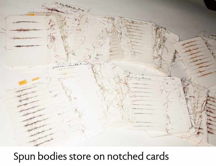

Attached are also some of the cards that Pete Hidy stored his bodies on. After a day or so, the silk would "set" so that when the dubbing loop was removed from the card, it would not unravel. Threads that are not silk are more likely to fall apart when removed from the card.

THANK YOU Gingerdun for those photos, especially of the blocks. Now I need to find a piece of leather or naugahyde. Maybe I can get a naugahyde sample at an upholstery shop...in black, and white... :D It never hurts to try.

Nice pictures of a neat bit of history. The 30 deg nail is a much better idea than how I positioned my own (note made for the Mk 2 block!) I imagine one could use any textured material for the "sighter" pad as the idea behind it would be to help stop the dubbing adhere to any remnant wax as much as being the background of contrast?
So the brass nails are fairly self explanatory, bu what is the chrome eschunion or upolstory pin for in the top of the block?

Fascinating stuff. Seeing the pic. of the cards
gives me some perspective as to the amount of time
put in to get the desired results... Some of the difference between

I and others find all that you share thrilling and very usefully. I think Clark's block and the method of dubbing itself to be timeless! Your photos of dubbing cards made me realize I can create some that are a lot sparser then anything I've created so far.
