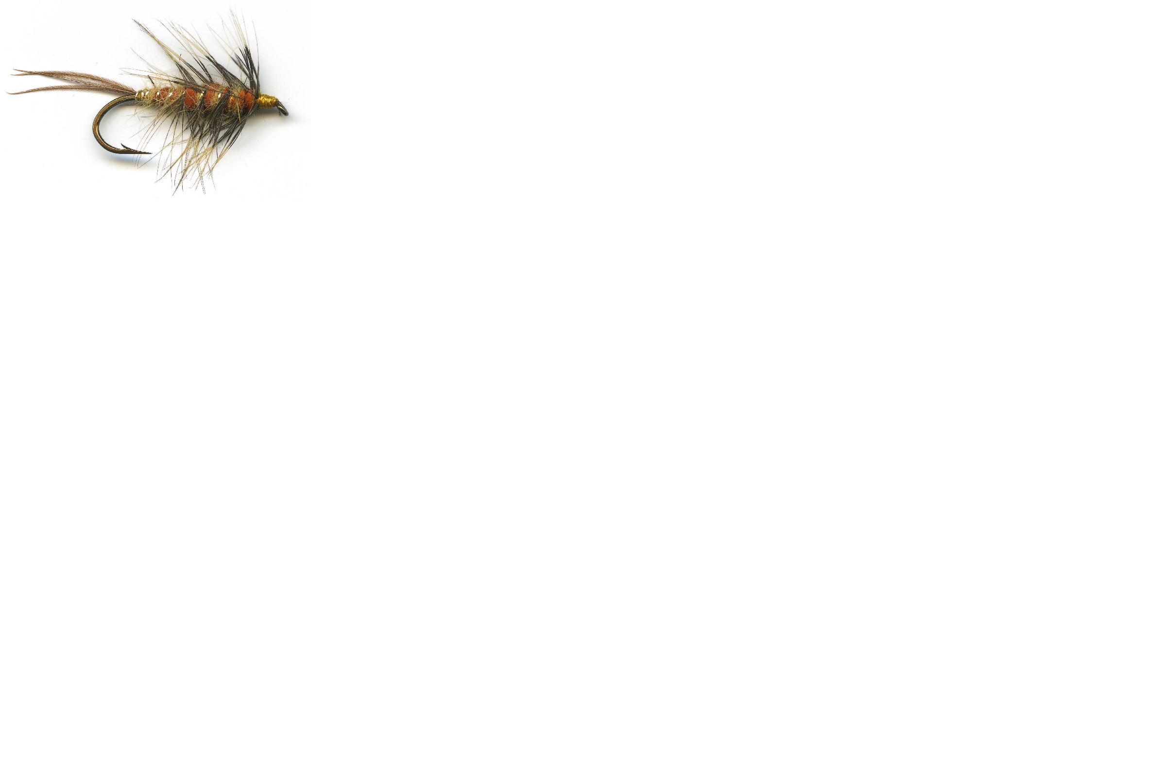

So this is one of my favorites to date, although a lot of the credit must go to the fly, most soft-hackles are not as compliant when asked so pose and the garish dye of the hackle is striking no matter the context. Still, this is taken with artificial light and offers a fairly warm presentation.
This is shot with the 40mm macro lens and a UV filter, at F18 and exposure time 0.7692. The Ott lights are above and to the right with an aluminum foil reflector to the left of the lens.
