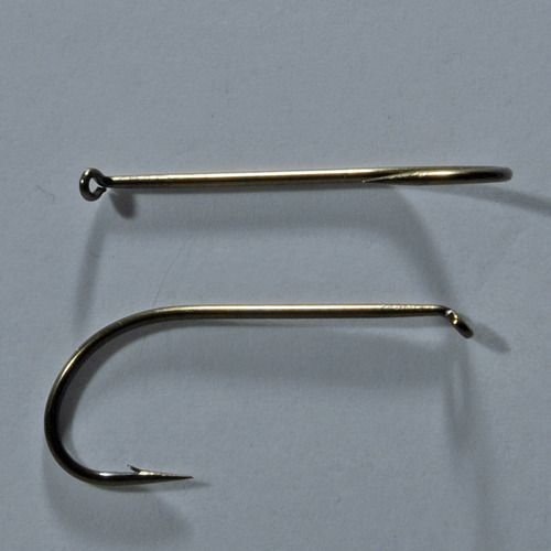

Jeff, this is what Partridge says of their current version of G3A:Mataura mayfly wrote:Partridge G3A?
I would be thinking about a Kamasan 830, possibly a B200. The 830 are 2XL. The 200 is a medium wire and what I would call 1.5 XL.
I think the Daiichi equivalent to the 830 would be the 1710.
The B200 is a deep water nymph hook and is a TD eye, 2X strong wire, forged 2XL with a Sproat bend. Not sure if it has a Daiichi equivalent.
The original G3A sure looks good. It doesn't say anything about being XL, but the new one looks XS in comparison.Wet Heavy Supreme

G3A old.Measurements for the new model (from https://mistpool.com/product_info.php?p ... anguage=sv:
Size Total length Gap width
#4 24,4 mm 8,5 mm
#6 21,5 mm 7,7 mm
#8 18,9 mm 6,8 mm
#10 16,0 mm 5,8 mm
#12 13,5 mm 5,0 mm
#14 11,4 mm 4,3 mm
#16 10,0 mm 3,5 mm
#18 8,4 mm 3,0 mm
I will have to check your other suggestions too. Thanks for your help.
