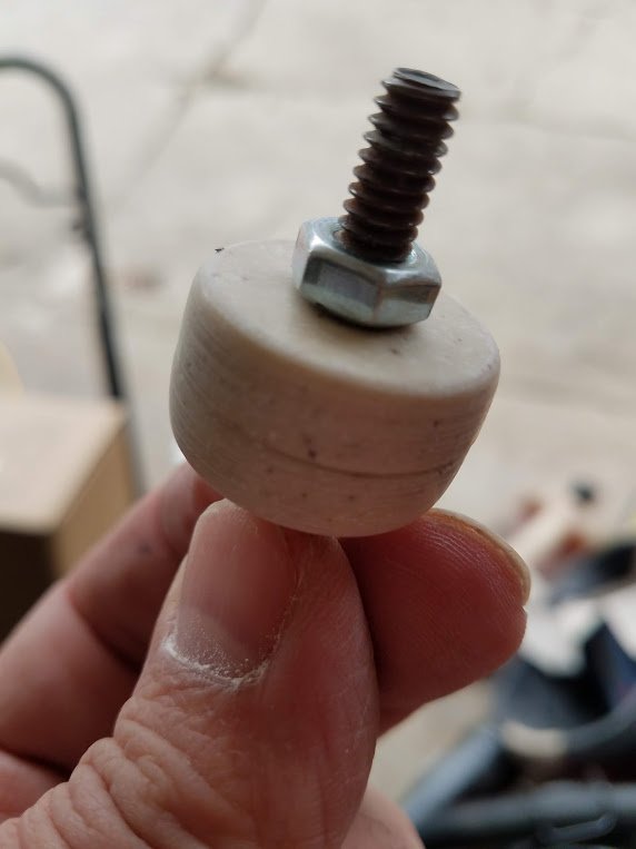

I've been wrestling with using pearsall's thread with the bobbins that I currently own. I looked online for a solution to my bobbin fitting the spool and saw a few ideas. This took about a half hr to complete and works pretty well. Thought I would share with the group. The material used is left over from my bathroom remodel. It's 1/4" solid surface counter material. The project cost me nothing as I had the materials on hand and already owned the tools.
The first step was to use a 1" hole saw to get the disks

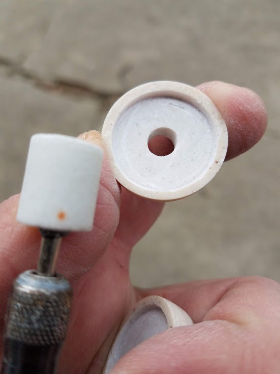

The next step was to use a 7/8" wood boring bit to make a recess for the Piersall's spool to set in to keep from slipping
Next put a bolt through both disks and sand to even them out with a power drill
Clean out any uneven areas in the recess with a dremmel tool

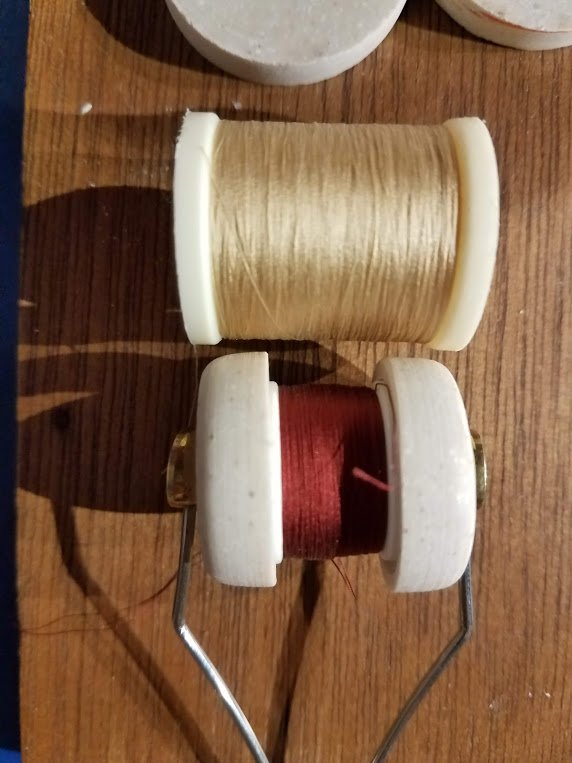

Check for fit and the finished product. The width is very similar to a Danville's spool and works pretty well

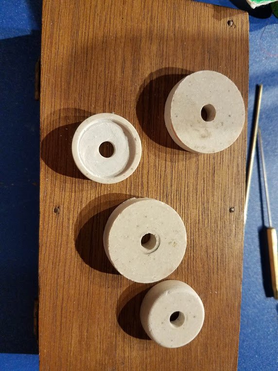

Here' a photo of the materials after using the hole saw. and size of the recess
