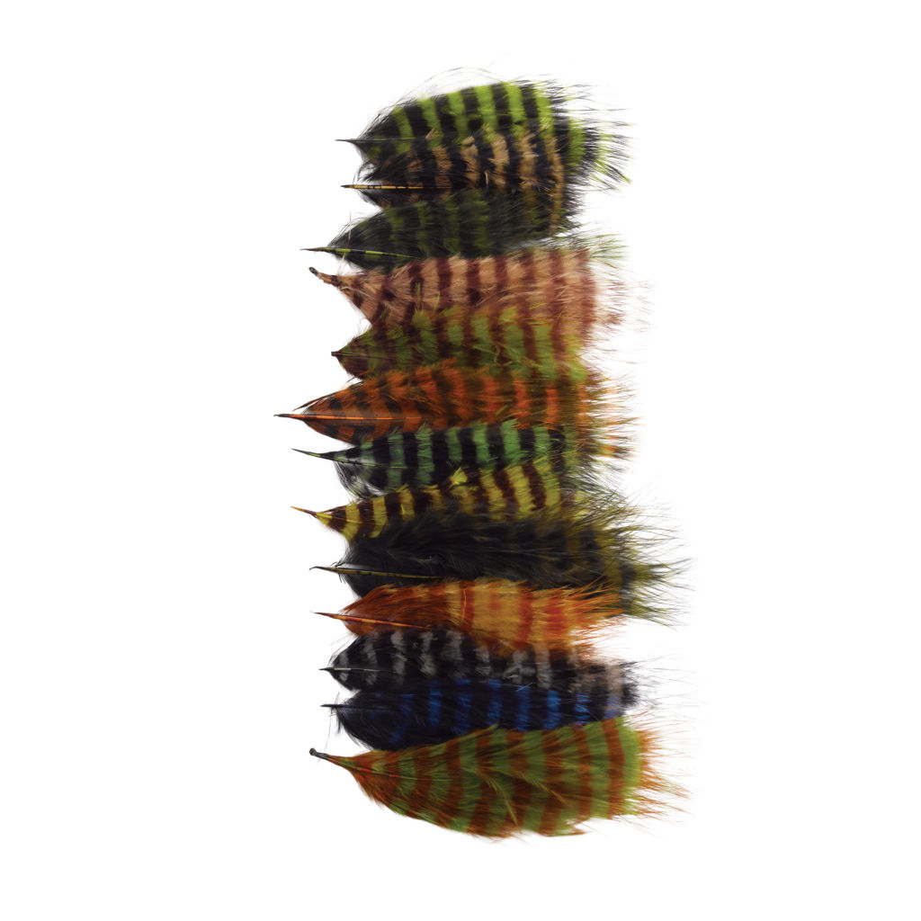

barred marabou would be interesting
Re: Kaufmann's Marabou Damsel
Posted: Mon Dec 27, 2021 10:53 am
Oooo... Very interesting indeed...
