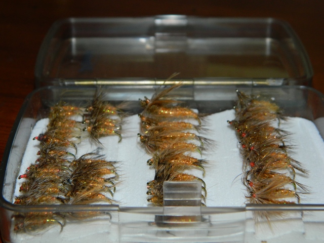

Here are a couple more photos of Doug's excellent Whitlock RFST nymphs ...
Doug's Red Fox Squirrel Nymph.jpg (228.25 KiB) Viewed 14773 times
Dougs' Red Fox Squirrel Tail Nymphs.jpg (190.93 KiB) Viewed 14766 times

Post by letumgo » Sat Sep 03, 2016 8:29 am
Bill,
Your post reminded me that I have fished one of Doug's curvy wiggle nymph versions too. Sure is a handome fly.

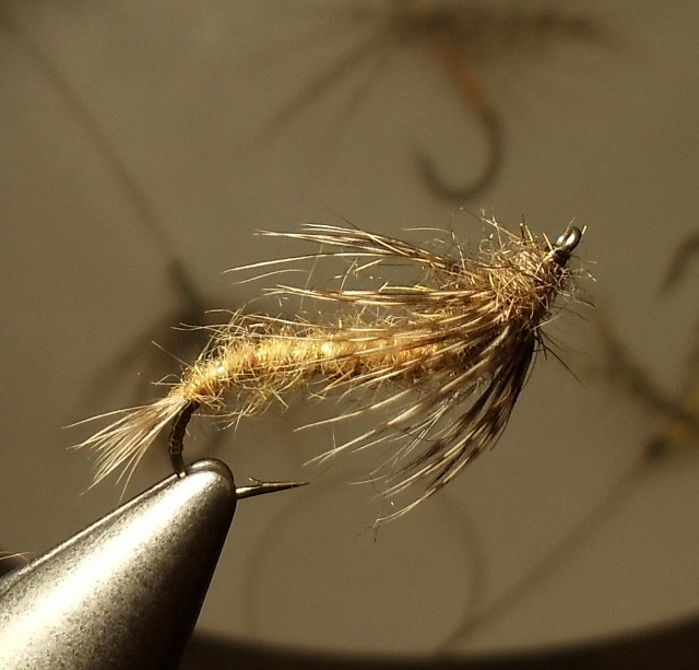

Replaced the dubbed thorax in Dave Whitlock's pattern with rat-brown ostrich from an old feather duster.
hook - Dai Riki 280 # 8
thread - Danville 6/0 brown
underbody - non-tox .030
rib - small oval tinsel gold
tail - fox squirrel back guard hairs
abdomen - dubbing fox squirrel belly/antron
thorax - ostrich herl dark grey/brown
hackle - hen (Dutch Welsummer)
Regards,
Scott

Scott - Gorgeous fly! Did you wrap the hackle thru the throrax, or did you twist the hackle with the herl before wrapping? I'd love to hear how you formed the hackled thorax. I love the look.

Thanks. Tied in some ostrich herl and the hen hackle by the tips, twisted the herl with the tying thread, laid the hackle over the herl rope, swept it all back with moistened fingers and wrapped it forward; finished with a turn of herl in the front.

Got it! Great technique. Thanks Scott.
