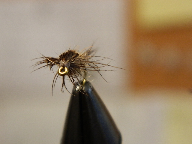

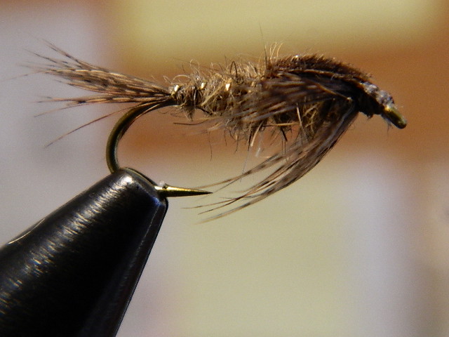

Post by DOUGSDEN » Wed Jan 04, 2017 3:38 pm
Side view
Side view
GRHE Dark 005.JPG (86.05 KiB) Viewed 13619 times
From my nymph box
From my nymph box
GRHE Dark 004.JPG (85.51 KiB) Viewed 13609 times
Hello Everybody!
As our good friend Ruard requested, here is the recipe for the GRHE Dark Version that did so well for me during my glorious afternoon on the 26th of December! The general construction of the fly is nothing unsusal. The fur is darker on this pattern than normally used!
Hook: TMC 3761 or Cabela's # Model 22 or similar in sizes 10-16
Thread: Danvilles 6/0 waxed in black or very dark brown
Lead: Left mostly to your liking and from your experience. On size 10's I use .025. On size 12's I use .020 and so on! I tied this series of nymphs with lots of weight for a reason. There are some clear deep lakes that I like to fish in my area that are known to harbor some big bluegill. They like to live deep so I decided to go after them with some fairly heavy weighted patterns and they worked terrifically well! If you are so inclined, a bead head version would work well too!
Tail: 8-10 dark Hungarian partridge fibers tied in short.
Rib: Moderately heavy gold wire (brass), three to four turns at most over the abdomen only.
Abdomen: Very dark hares ear dubbing or similar. I had trimmed, Shanerized, and blended some cottontailed rabbit faces a while back and they turned out very dark and spikey. Proved to be good stuff to work with!
Thorax: Same as abdomen or sometimes a lighter shade of hares ear dubbing. Dubbed rather thick and then roughed up with Ruards velcro "scratcher". That tool is awesome for this job and many others too!
Wingcase: Darkest, well mottled fibers from a turkey tail folded over in the usual way to cover the top part of the thorax!
Hackle Collar or Beard: A fairly long Hungrian Partridge dark and well marked wrapped 2-3 turns and then divided and pulled down to make a backward sloping beard. Pull the wingcase forward and secure. Whip finish a small head and cement!
Tying notes: When this pattern gets wet, it gets really dark! The filmier parts of the hares ear dubbing, when teased out with Ruards scratcher, make a nice veil which is where I think alot of the darker parts of the fur come out and really darken the pattern! I hope I haven't forgotten anything?
