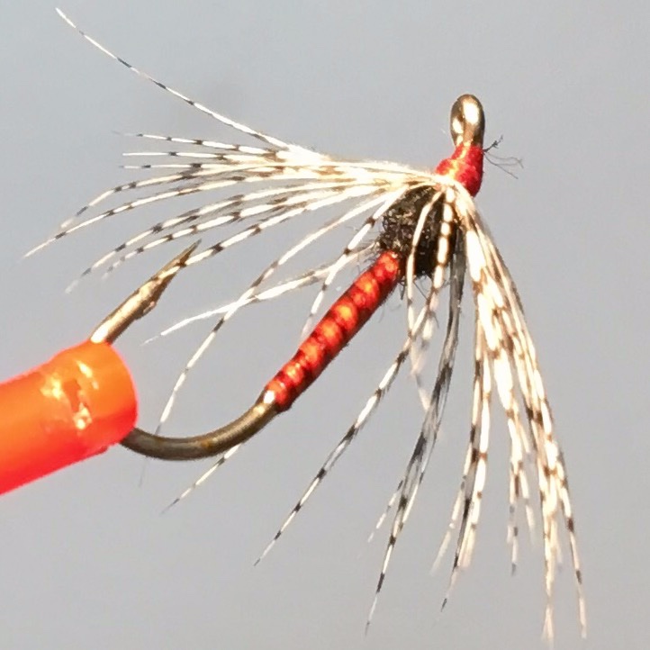

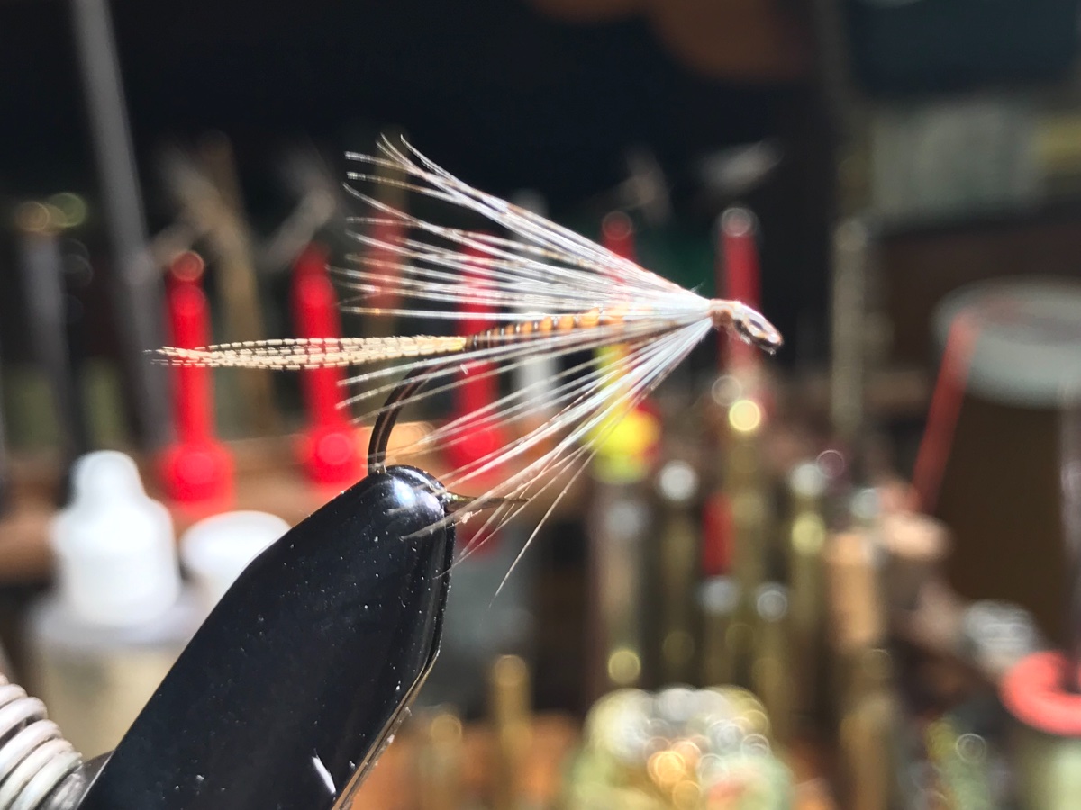

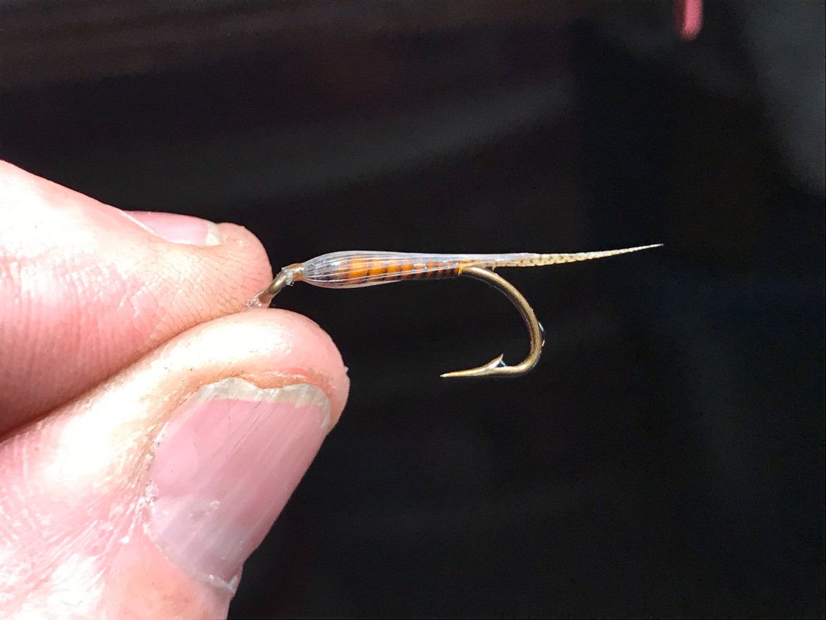

Here’s a few pictures of some I made over the weekend, what do you think?
Scotch tied Mallard quill body, wet
Scotch tied mallard body
Mallard quill body
Mallard quill body

Does the soft hackle actually wrap around the body of the fly when it is in the water? I am referring to the first photo.
Yes - The hackle undulates back-and-forth.......That’s the main reason that Scotch tied hackle is soooo deadly!
