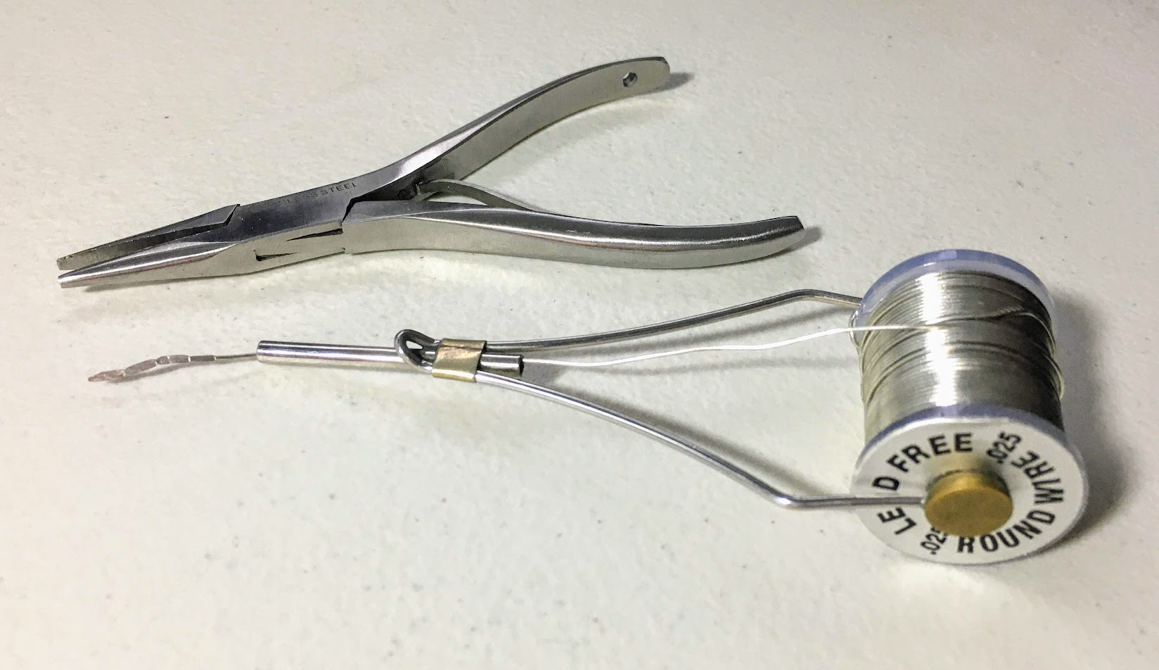

Special Tool Needed:
- Needle Nose Pliers with flat jaws
Close-Up View of the flattened wire core (this helps form the body taper)
TYING SEQUENCE/Step-by-step Tutorial
Flatten roughly 3/4" section of the end of the wire with the needle nose pliers. The pliers can easily flatten lead-free wire (and lead wire).
Mount the hook in the vice, then wrap the weighted wire underbody forward. F
Once you wrap the flattened section of wire, continue wrapping the middle section with the round wire. Once you have the desired number of middle wraps (six or seven wraps in this case), then use the pliers to flatten another section of the wire near the front. Continue wrapping forward, then break off excess when you are happy with the overall length of the underbody.
Ray - couldn't help but to notice those very nice stainless flat jaw needle nose pliers.....where did you get them, and what is the make???? :geek:

Very nice needle nose pliers!

Dana,
I do not remember where I got these pliers. I looked at them when I got home, but could not find any brand name on them. Sorry buddy.

Dana, Check jewelry makers tools. My wife picked up a couple sets of fine smooth jawed pliers from a friend who makes jewelry. These may work for you. https://www.gesswein.com/p-10958-valuel ... -nose.aspx
I have what look to be the same make/model. I'm pretty sure that I picked them up at one the Fly Fishing Shows, probably when they still had one in Maryland, but possibly Somerset.
