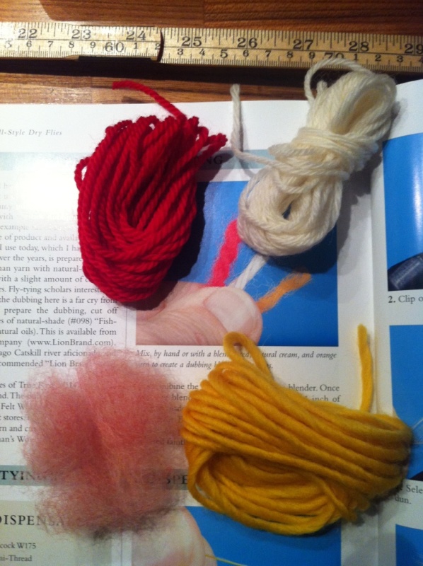

Made some wool dubbing according to Valla's recepie and Ray's wool
Martin
Martin
- IMG_1534.JPG (175.2 KiB) Viewed 21745 times
