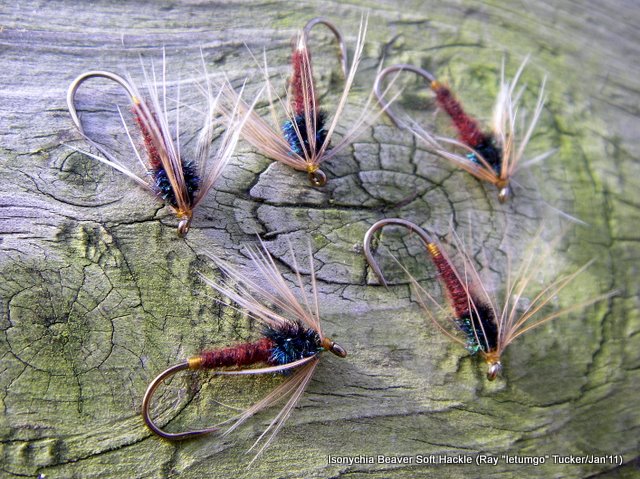

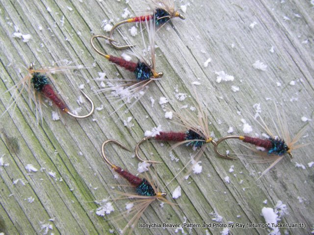

Post by letumgo » Sun Jan 02, 2011 12:51 pm
Isonychia Beaver
Hook - Daiichi Model 1710/Size 12
Thread - Pearsall's Gossamer Silk (Gold/6A)
Hackle - Indian Hen Saddle (Ginger Speckled Brown)
Tag - Three Wraps of Pearsall's Gossamer Silk (Gold/6A)
Abdomen - Beaver Dubbing (Isonychia)
Thorax - Peacock Sword Fibers (Natural Metallic Blue)
Head - Pearsall's Gossamer Silk (Gold/6A) coated with Sally Hansen's "Dries Instantly" clear nail polish

Nice looking fly--I especially like the "accents" of the silk tag and head. :) A question for you: how are you using your peacock swords, one at a time wrapped perpendicular to the shank like hackle, or a few captured in a dubbing loop and wrapped on? Otherwise, an excellent "get" on that dubbing...I've been looking for a "mahogany" mix for a while.

I used five long (~ 1.5" to 2")peacock sword fibers tyed in by the tip. I then grasp all of the sword fibers, by the base of the stem, in a hackle pliers. Then twist the sword fibers together and wrap them forward, forming the thorax of the fly. The sword fibers seem to be a bit tougher than peacock herl, so I decided to skip the dubbing loop. If I wanted to reinforce the thorax a bit more, I would probably add a drop of cement to the hook shank before wrapping the sword fiber over it.
There are two main reasons I did not use the dubbing loop method:
1) Cosmetics - I did not want the light color silk showing thru in the thorax area
2) Mechanics - Sword fibers are fairly short, so it is harder to neatly form the dubbing loop and still have enough material left to wrap the thorax. I find that the material gets somewhat shorter when you twist it in a thread dubbing loop. This is not a problem with peacock herl, due to the longer length. Peacock sword stems just tend to be shorter and thus a little different to work with.

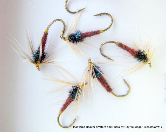

EDIT - Adding new photo taken in natural sunlight to better capture the color of the flies
