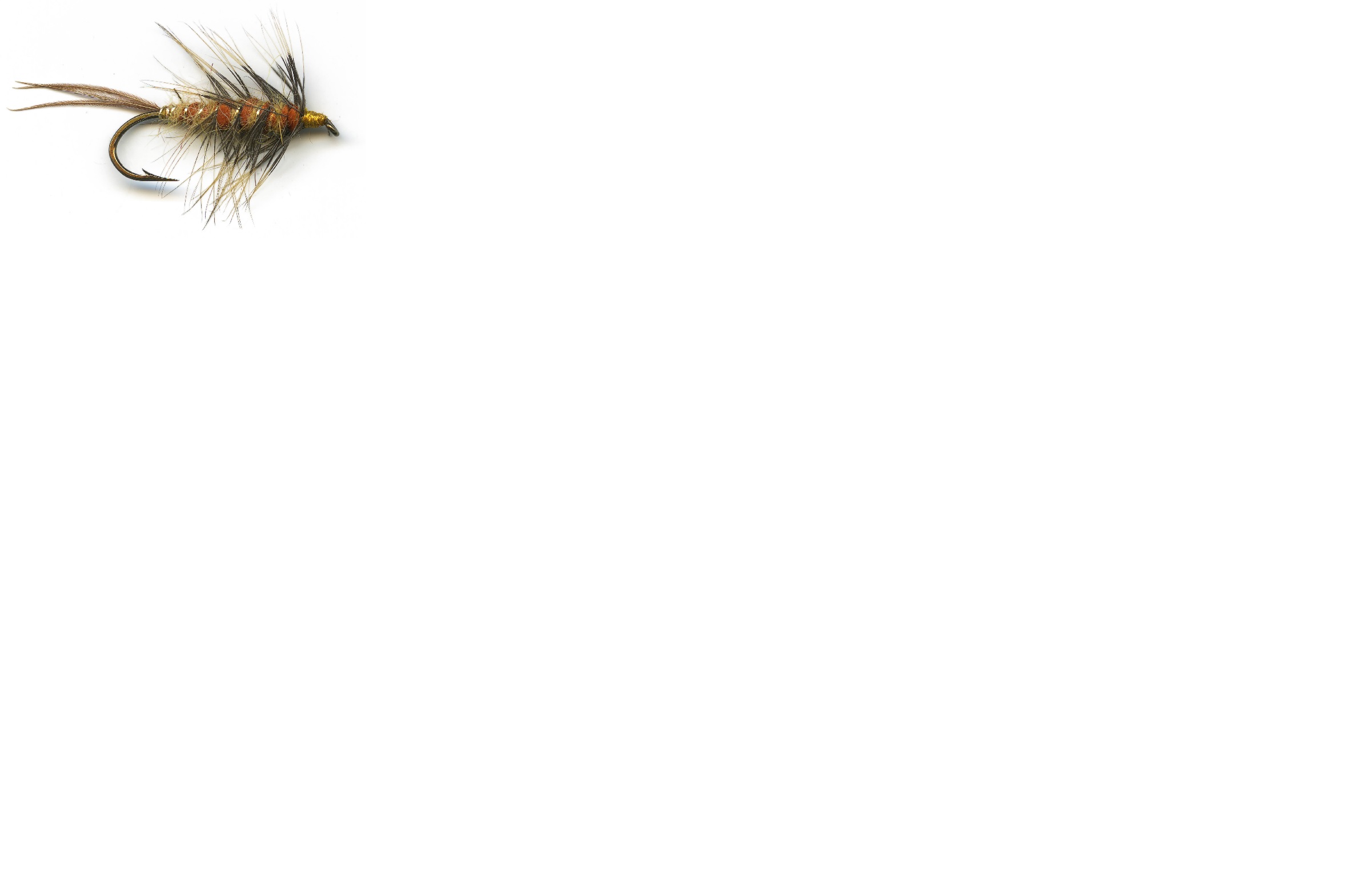

Three from Lance Hidy.
Lance Hidy uses a high end scanner for his graphics work and it's an excellent way to document flies. For these images he's trying to capture the texture and tones against a white background to make the flies as legible as possible. Part of a process for publishing fly patterns. These high res images printed on a white page in context with their description eliminates the hard edges of an image. Graphically much easier on the reader. He's taken the literal documentation of the flies to a new level.
And this from Lance was just remarkable. The materials and the quality of the spun body do a lot to describe the nature of these flies.
