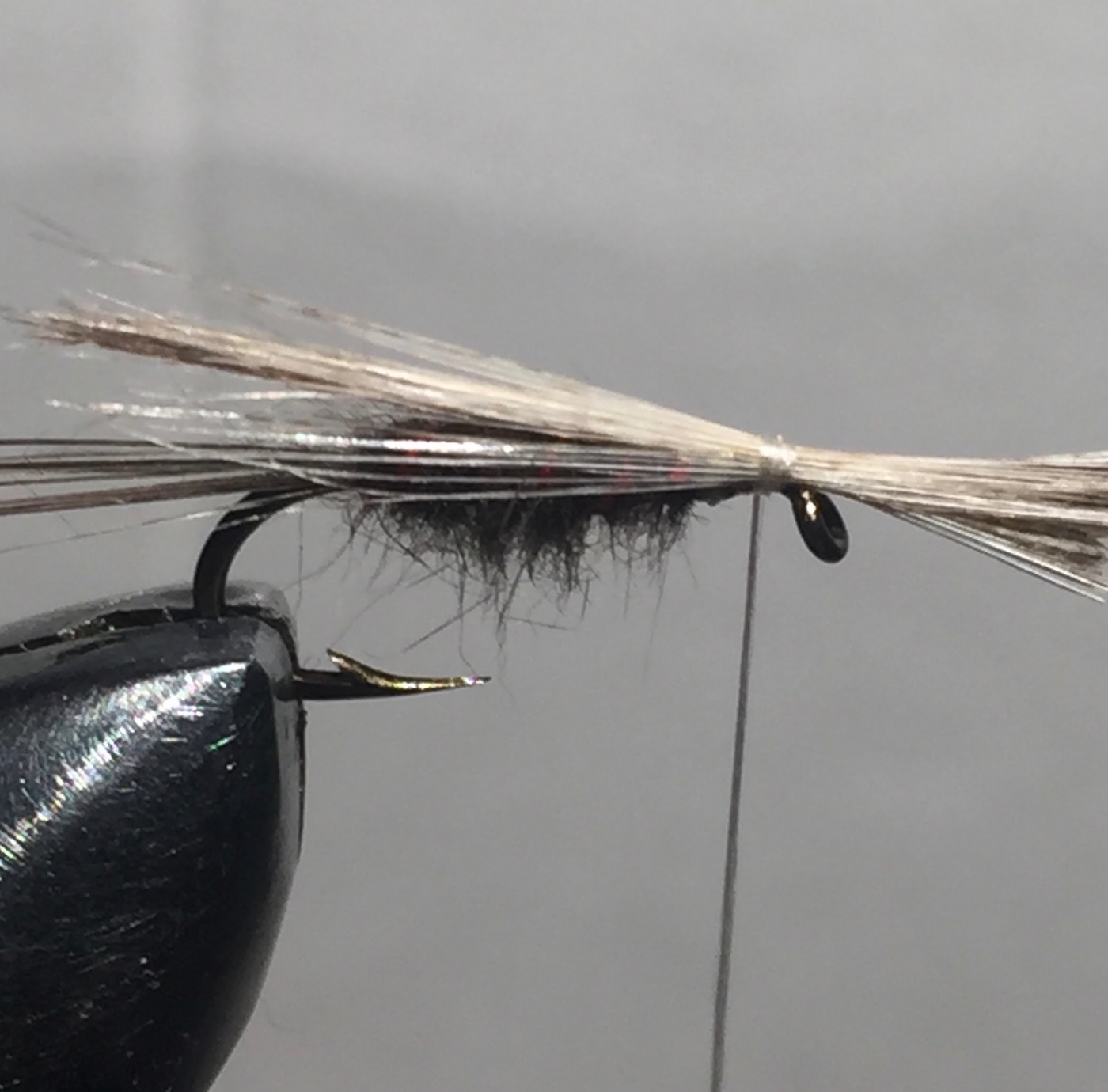

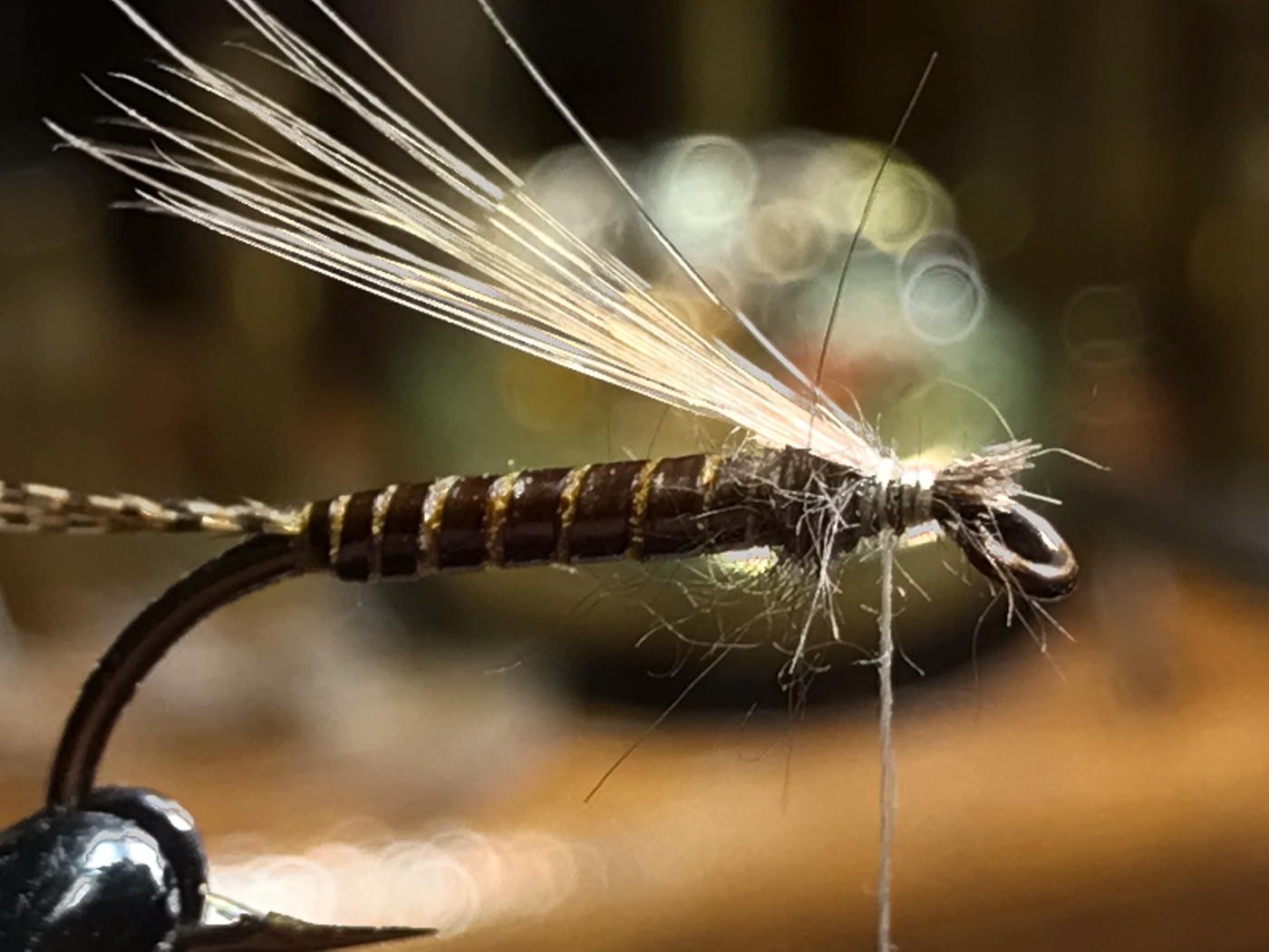

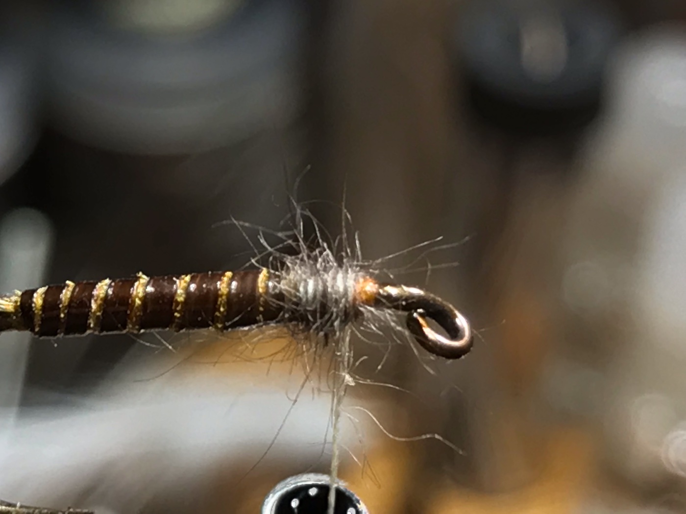

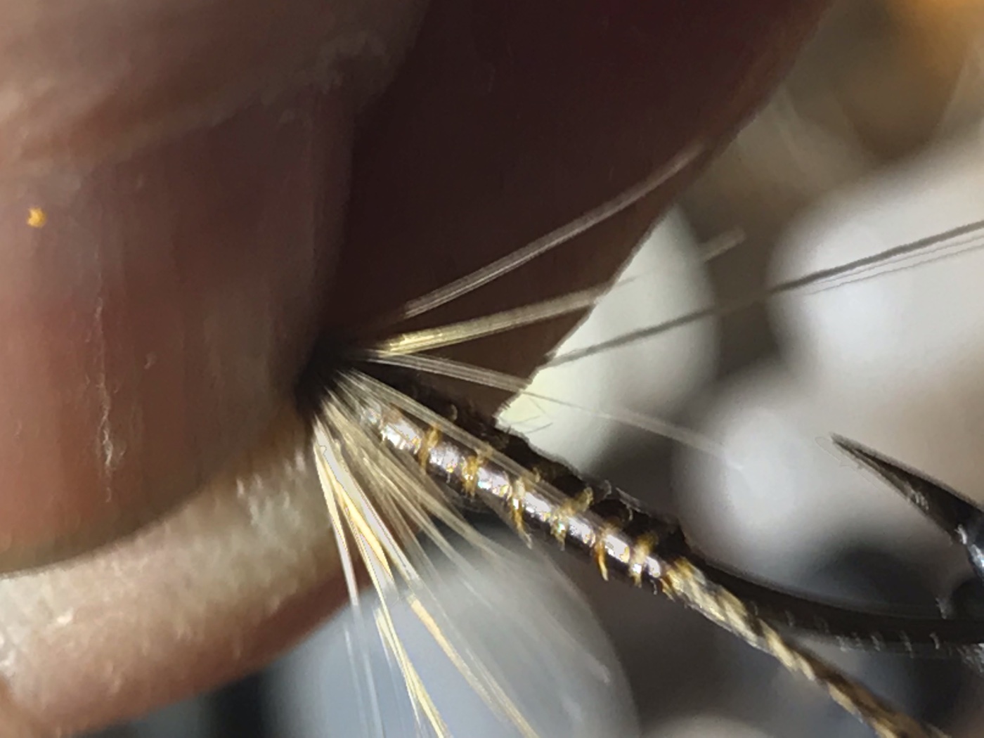

Originally shown to me by Ivan Willard in the 1980's, this method of hackling a fly is one of the very best in my arsenal.
THE most important rule in dressing flies(or most anything else in life) is this: "the impression left from your first movement dictates the success of the following step."
The act of tying a fly is a journey - either you triumph at the end, and marvel at your beautiful specimen, or bring out the razor...
This method can be used myriad ways, for just about any pattern, but for this exercise, have a fly completed up to the point where you would "hackle it". DO BE SURE to have a neat, tapered base to lay your hackle barbs upon - this is key. There are other variations, but for now we will stick to the basic method.
Step one: Find some long, flecked feathers, usually at the bottom end of a cape.....the ones you could tie a size 4 or 6 dry fly with(but usually do not), or use for tailing. Fold the hackle & straighten the barbs.
Step Two: Pluck off a dozen or so barbs, keeping the tips even. Trim the curly ends that were attached to the rachis.
Step Three: Lay this bunch of barbs on top of your gradually tapered base. Secure with the pinch loop, and two loose wraps. key to this technique is the same as every other if tying(or life for that matter): you MUST have a proper foundation for the hackle to behave in the manner you seek. You're finished product may require flared or flat barbs - either way, the base (and thread tension, to some extent) determines said barbules final position.... but its 90% base shape and angle.
That being said, I find silk to be the best thread for this application. I use silk: Belding, Lions Head, Reed Tackle, Pearsalls, Gudebrod - any will work, and work better than man made fibers..
Another key component is the hackle you choose: select long, limber, translucent feathers with sparkle. Early Darbee duns have this rare characteristic, which has been lauded by Atherton, Jennings and others from the golden age.
Once you get the feel, and master the basic Scotch tie, you WILL see this opens up a world of possibilities for those long hackles that previously were relegated to streamers or tailing material. Try this: make a steeper taper on your base, leaving a single space thread "groove" at the top of your taper - proceed as normal, approaching the "groove" with normal wraps. However the wrap directly over the "groove" should be pulled tight: this will flare the barbs outward, giving the appearance on a wrapped feather....but it is much more durable!
This is my first SBS, and I am clearly not the best at this....your comments are welcomed!

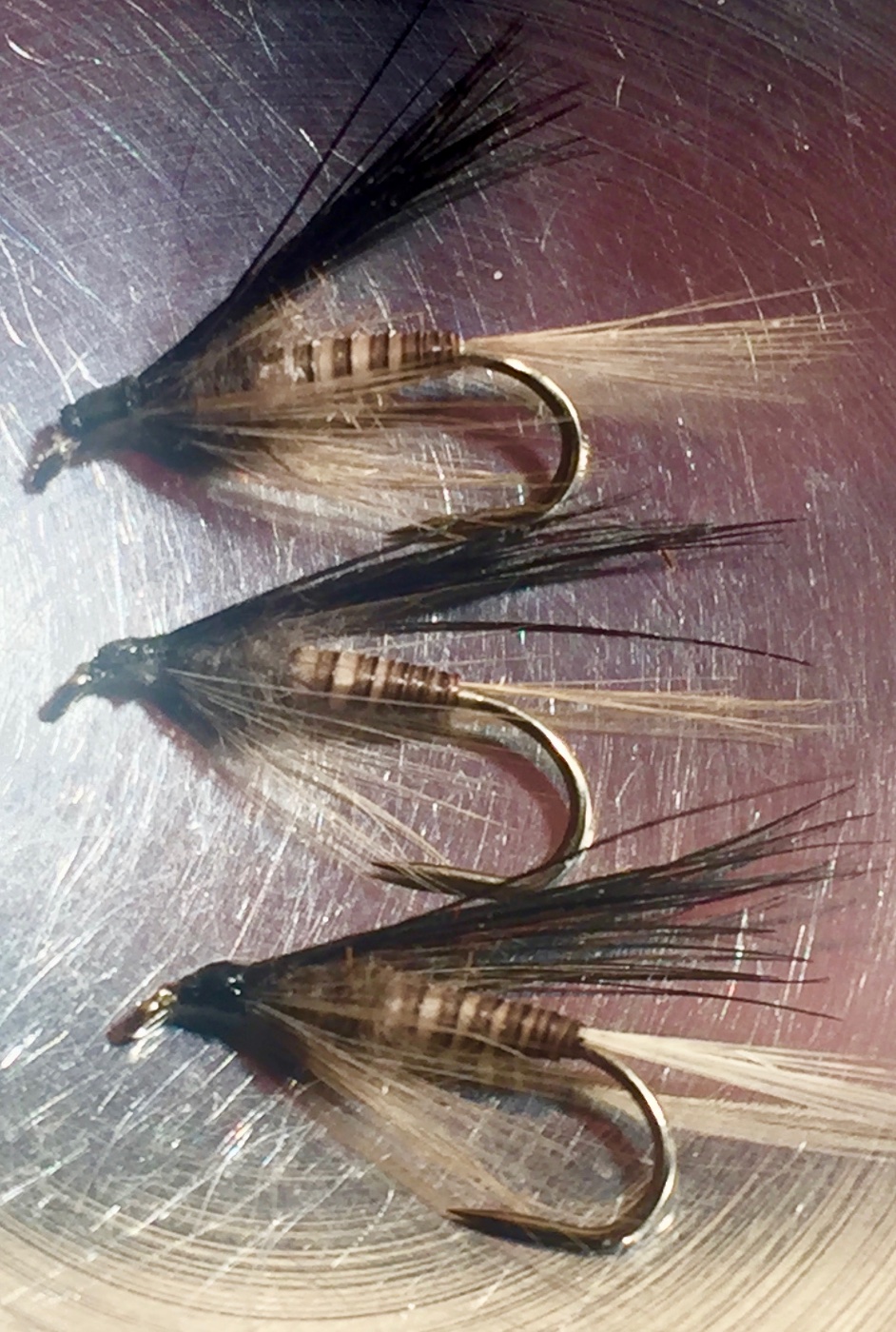

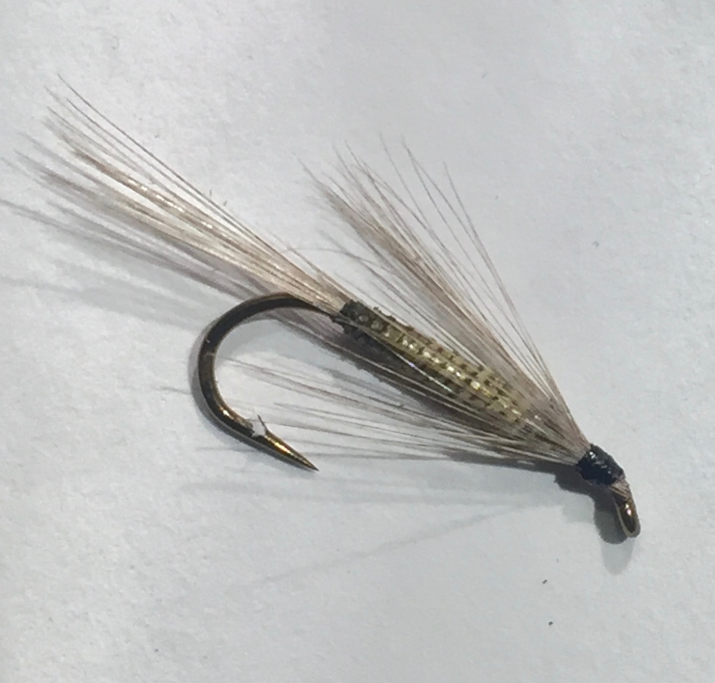

- Condor Quill Gordon emerger
- fullsizeoutput_79c.jpeg (442.87 KiB) Viewed 8900 times
- Olive Quill, Daiichi 1710, Darbee dun
- fullsizeoutput_94b.jpeg (306.13 KiB) Viewed 8900 times

Dana ~ Do you use only thread tension to distribute the hackle barbs equally around the hook?
Re: Scotch tied hackle SBS
Bill
No: I use my thumbnail to slide all of the barbs around. - Sometimes I leave them on top, sometimes I spread them around, depending on the pattern.

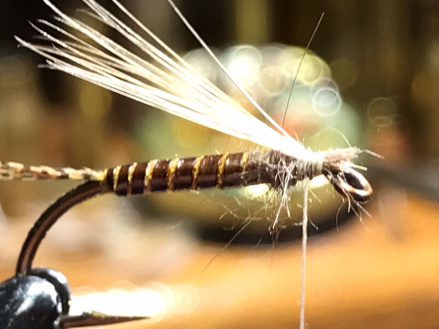

Note how the hackle angle matches the slant of my thread base........

That clears up a couple of points. Thanks, Dana -- great job.
