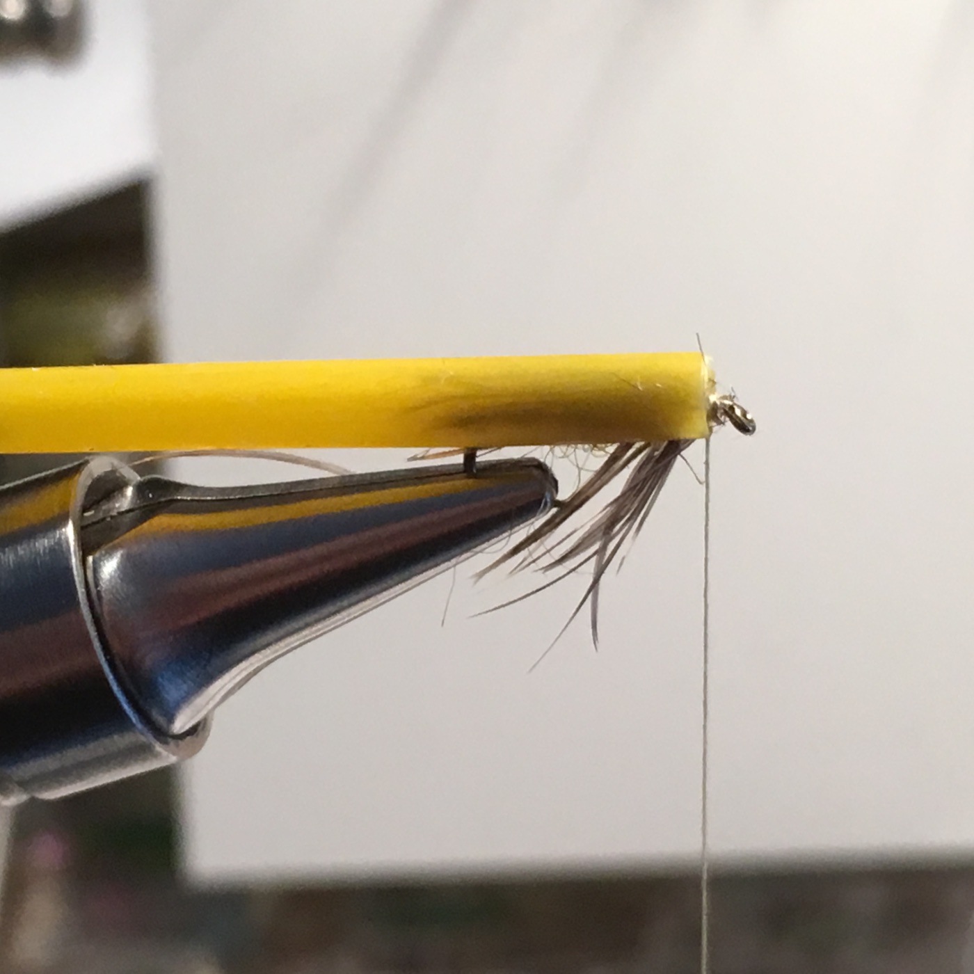

For quite a few years, a friend and I were invitied to tie flies at the "Celebration of Fly Tying" event that used to be held in Grand Rapids, MI.
During the fly tying, we used a small "tool(?)" to hold back the hackles before doing a whip finish. It never failed that during each event, quite a few people would say something (after watching us use the "tool") like: "That was worth the price of admission." So we started bringing a few extra with as give aways.
The "tool" is made, as follows:
Take the small yellow, plastic straw that comes with a "Capri Sun" drink then cut the straw into pieces approx. 1 1/2" long.
At one end of the straw, take your fly tying scisssors and cut a 45 degree angle in the straw. At the bottom of the angle, cut a straight line from the angled bottom to the square end of the straw.
After cutting the straight line, go back to the angled end and cut a small "V notch" at the end of the straight line. The small "V-notch" allows the fly tying thread to move forward as you slide the "tool" over the hackle which, in turn, allows for doing a clean whip finish.

a picture of the finished tool would be nice...
Re: Hackle Folding Tool
Cut a straw 1 1/2" long; 45 degree angle at one end flat of the other; full slit at bottom of the 45 degree angle; cut a little V-notch in slit at bottom of angle. Will try to take a pic.
