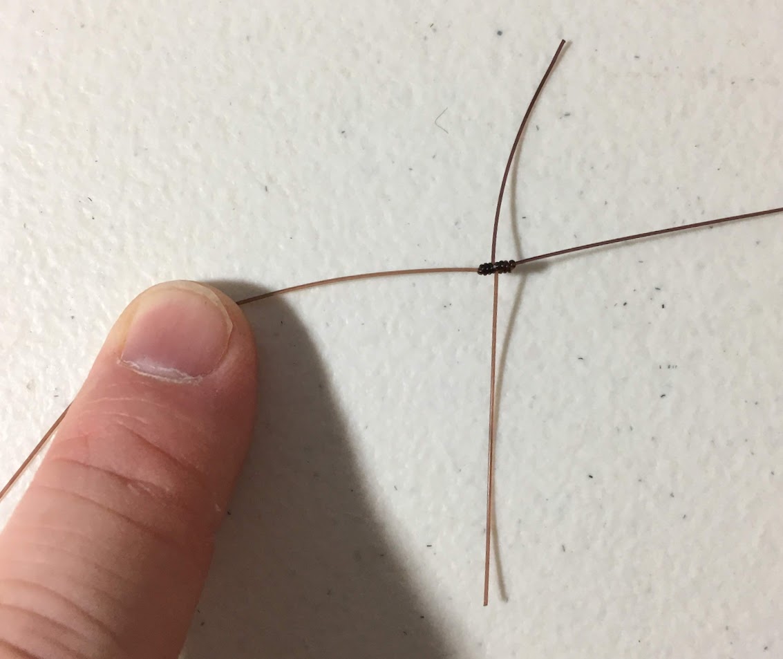

Blood Knot

KNOTS NEEDED: Perfection Loop (at each end), Blood Knots (joins each section of leader material together) and Figure Eight Knot (joins the three sections together and ensures loop ends align with the main furled leader section).

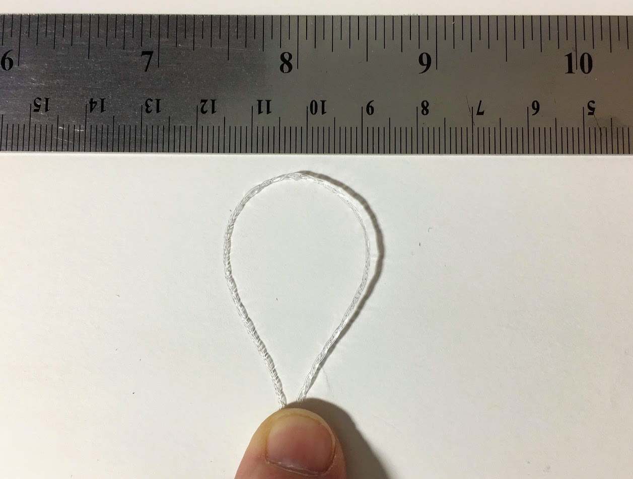

I have been thinking about the furled leader design over the past few days, and think I've come up with an effective progressive taper design (see diagrams below).
With a three loop design, one can have a nice progressive taper.
Demonstrating Three Loop Design:
By staging the knots at different locations along the furled leader, the taper is very uniform.
Notice how smoothly the leader transitions from one section to the next. In theory, this should result in an efficient transfer of energy thru the whole length of the leader (field testing needed to refine design):
