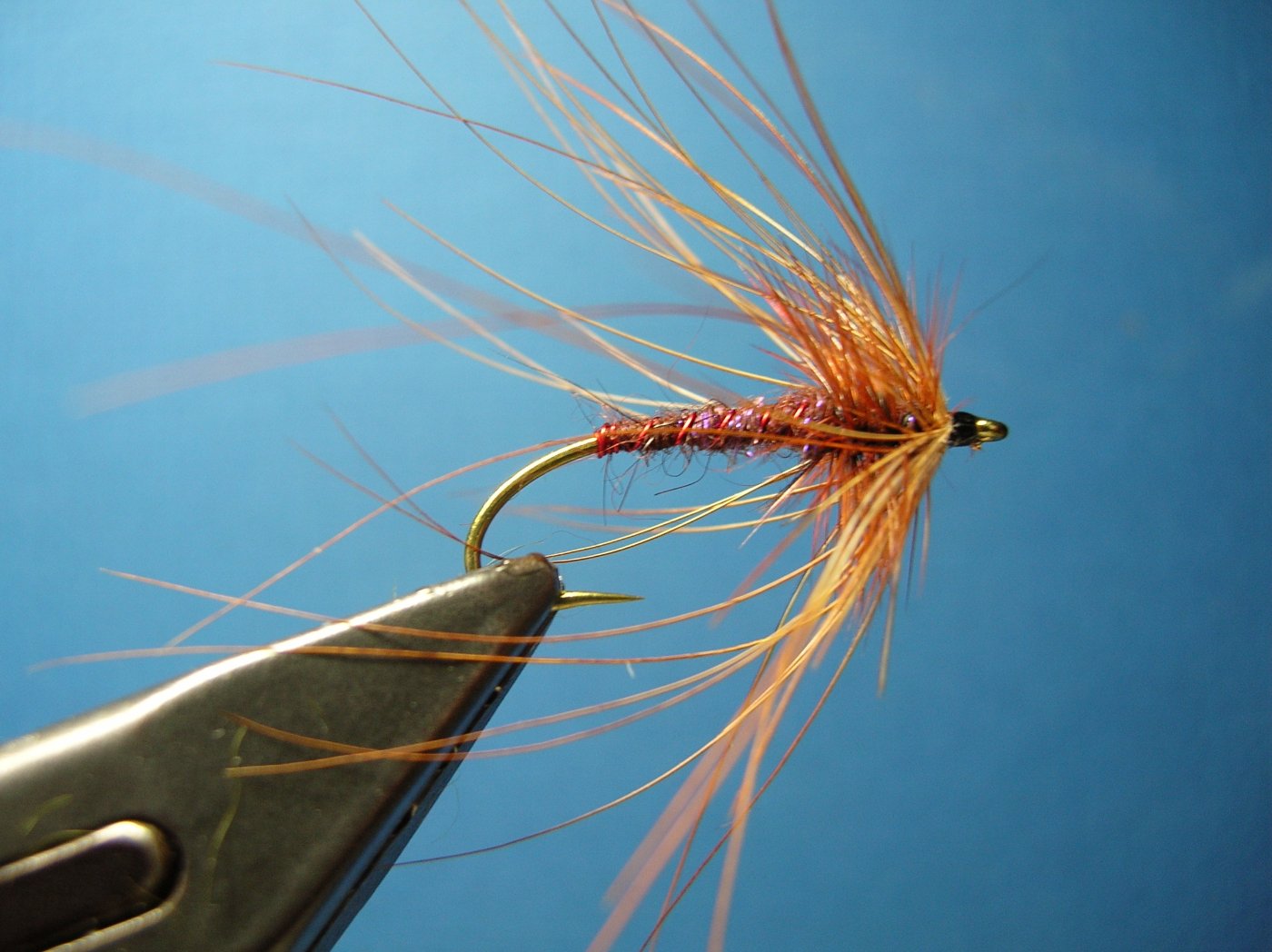

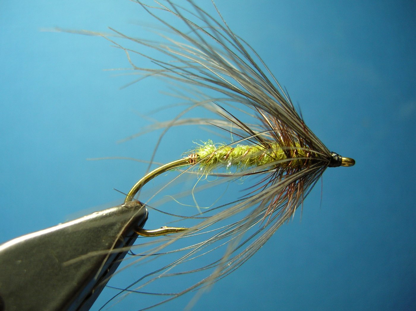

Ray, here's a couple of flies I tied using this technique. Both are tied on size 6 TMC 200R. Top fly has a body of brown possom with a touch of UV Ice Dun added, ribbed with red wire. Furnace rooster for the thorax hackle and ring neck pheasant rump for the front hackle. The 2d fly has a green possum body with a touch of UV Ice Dub added, copper rib, furnace rooster hackle for the thorax and a Coot flank feather for the front hackle.
