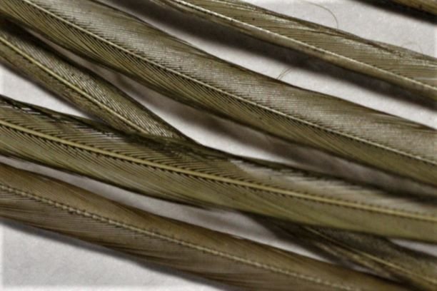

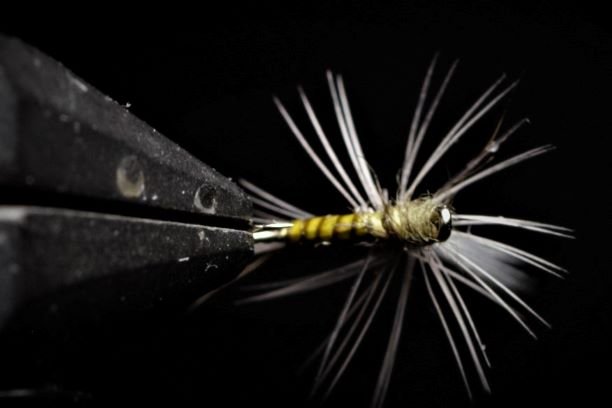

Here's my custom "bwo" color even on a substandard quality (hand stripped) quill:
BWO Parachute Quill from Below with Hand Dyed Peacock Quill from Flytire.jpg
BWO Parachute Quill from Below with Hand Dyed Peacock Quill from Flytire.jpg (32.25 KiB) Viewed 9371 times

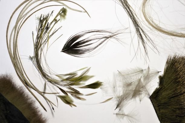

Here's the materials:
BWO Dyed Materials.jpg (47.83 KiB) Viewed 9371 times

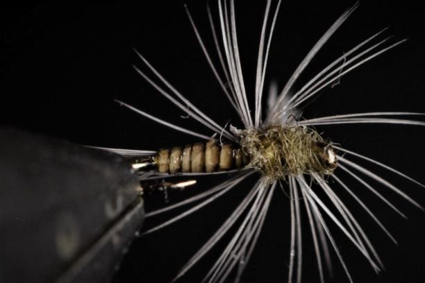

Thank you all for the nice welcome. I just realized the flies I posted were not flymphs... :roll:
Either way, here are some close-ups of the materials in BWO color...

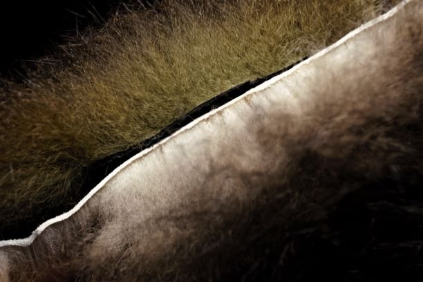

Australian possum, one dyed and another natural for comparison:
BWO Dyed Australian Possum.jpg (43.65 KiB) Viewed 9317 times

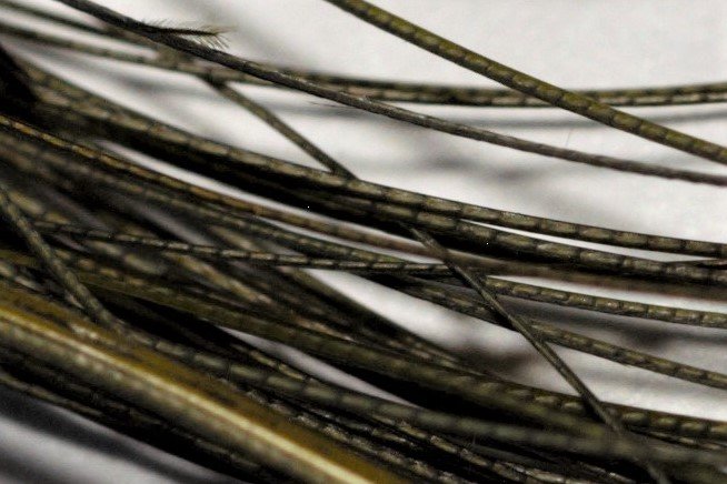

Stripped neck hackle:
BWO Hackle Stems Close.jpg (89.65 KiB) Viewed 9317 times

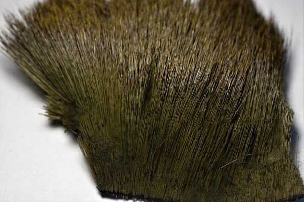

Deer hair:
BWO Dyed Deer Hair.jpg (53.65 KiB) Viewed 9317 times

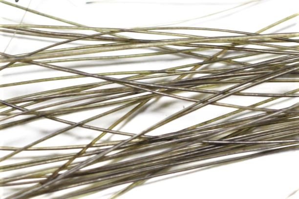

Horse tail:
BWO Dyed Horse Tail.jpg (51.9 KiB) Viewed 9317 times

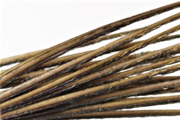

Peacock eye quill:
BWO Peacock Quill.jpg (45.41 KiB) Viewed 9317 times

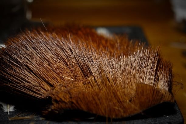

The last is a nice orange brown I tried for some rusty spinner bodies and threw in a patch of deer hair to use the extra dye:
Deer Hair Dyed Orange Brown.jpg (49.64 KiB) Viewed 9317 times
