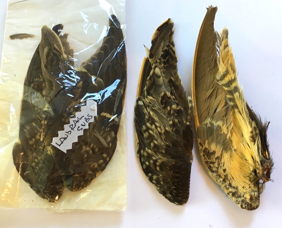

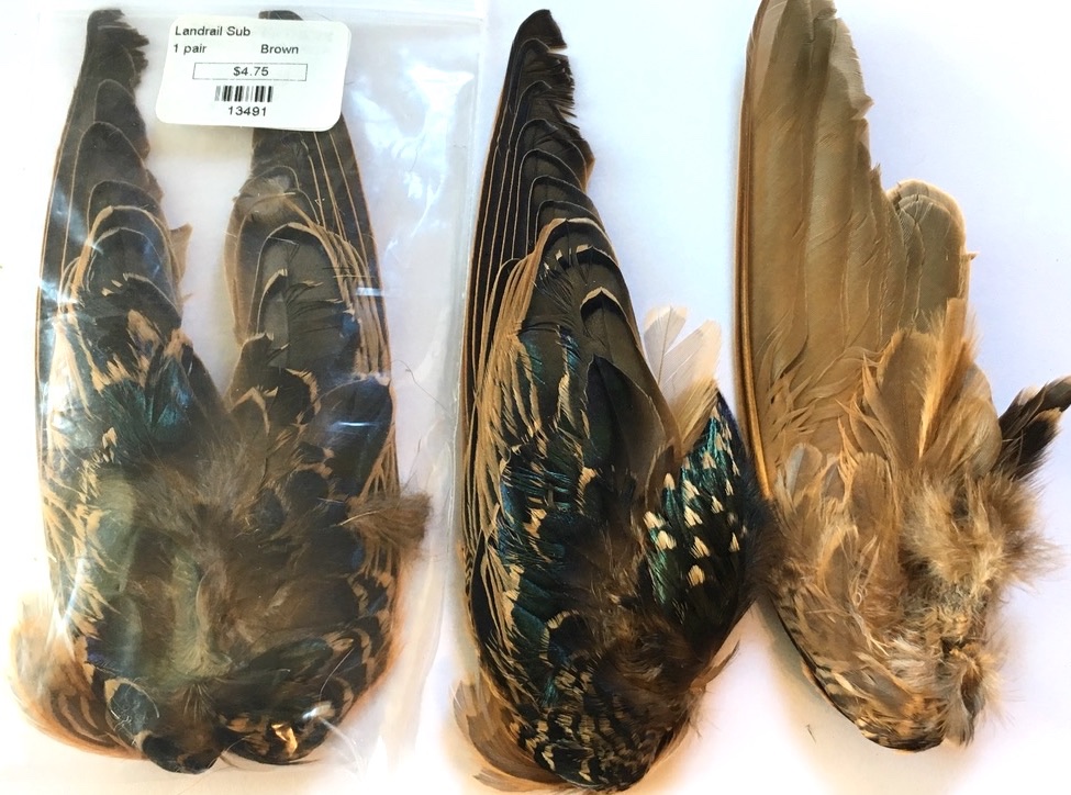

Post by joaniebo » Mon Mar 04, 2019 5:45 pm
I might have posted these before.
Landrail Sub Inherited.jpg (238.7 KiB) Viewed 4714 times
Landrail Subs.jpg (219.29 KiB) Viewed 4714 times
