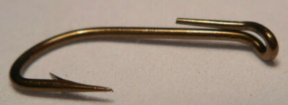

If you search the internet you can find old style wet fly hooks with looped eyes. Quill wings are easier to mount because you are tying on a flat surface. You will be limited by size and hook type. Also, like many things, these hooks will eventually disappear. Then, as stated, it is practice, practice, practice.

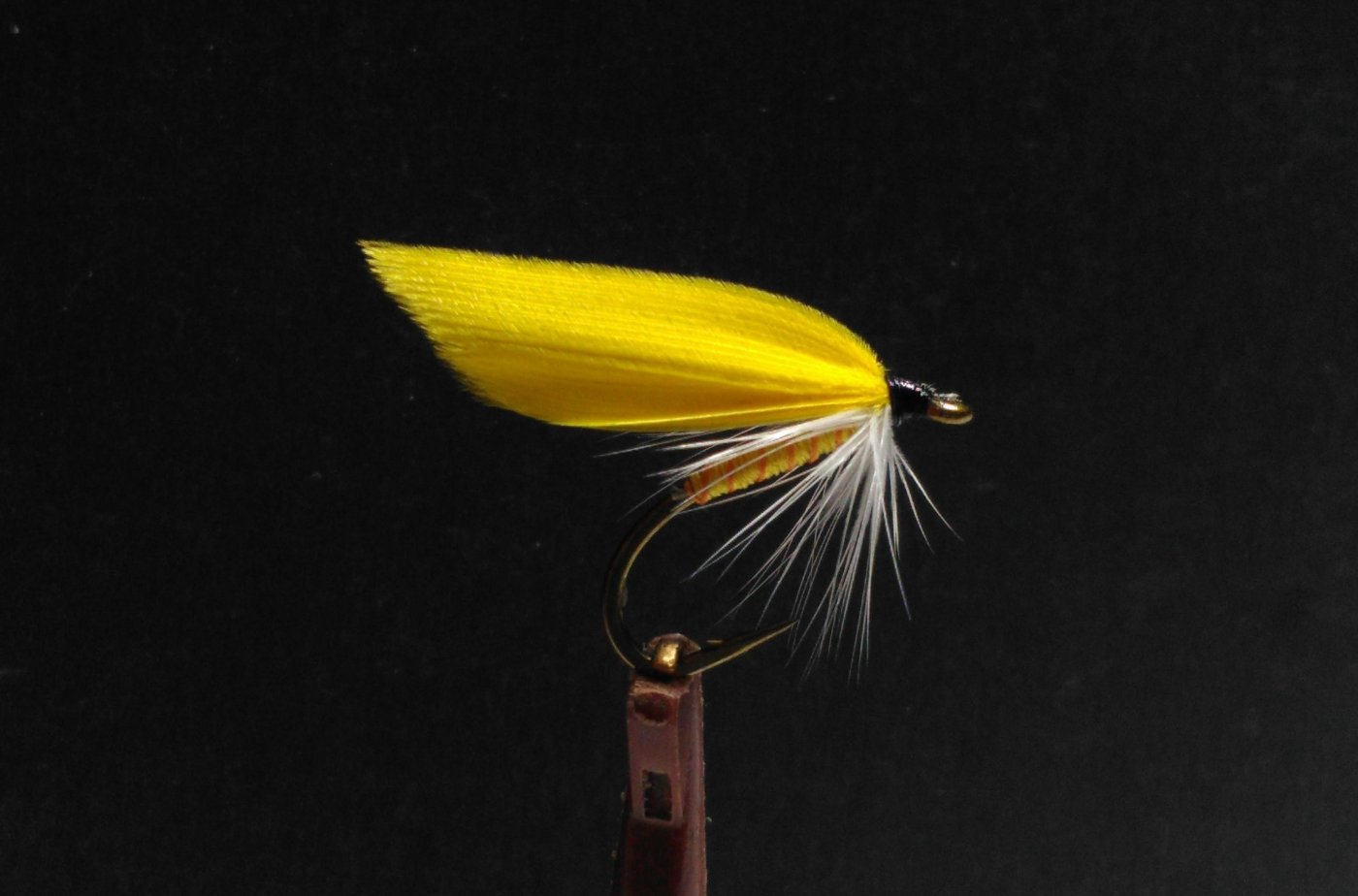

I think I'm getting it.
I find I do better by pinching hard and slightly toward me, then two light wraps around the shank and then very quickly pulling up. If I pull up slowly the wings turn and lay flat no matter how tight I pinch them.
Keep in mind, I'm still practicing.
Re: Discouraged
Looks great. Nicely set wing, and no distortion of the fibers. Your efforts are paying off.
