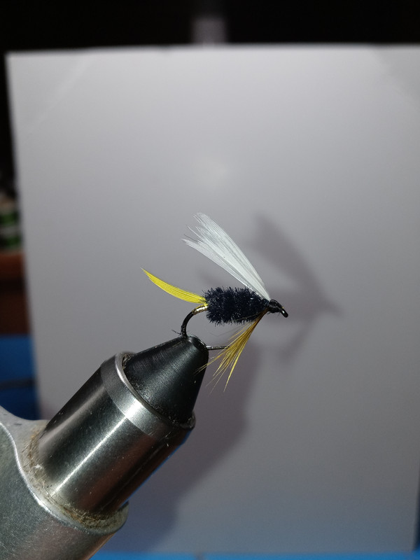

Hey friends, I have been wanting to tie the wet fly version of the Rio Grande King for about a month now and I finally got my materials.
I have never tied wings like this before and I have watched many videos tying flies with this style of wing and it looks simple to me, but I am struggling really bad. I have seen videos where they take matching sets of wings and place them together and I have seen videos, Davie McPhail does this a lot, where the fibers are just folded in half and tied in.
I have tried both ways and my wings keep wanting to lay flat no matter how much I lay them in the opposite direction so the thread will stand them up.
This is what they are looking like. I need some help, please.

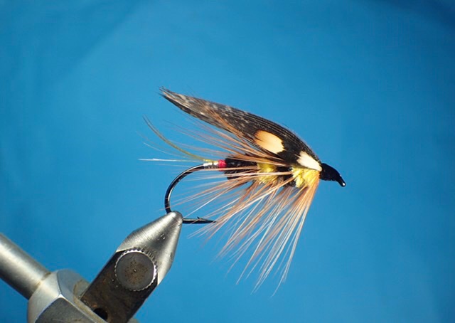

i have watched davie mcphail tie on wings and i just cant do it the same way
i will say this: i would use small/fine chenille for the body. medium chenille will create a dam and cause the wing to elevate instead of laying flatter over the body
pair up your wing slips from a right and left pair of duck or goose wings
width of the wing slips are approximately 2/3 the gape of the hook (I learned this in a don bastian tying class)
watch barry ord clarke tie wings
davie mcphail. notice the width of the wings after he ties them in

So I practiced and I am now able to get the wings to somewhat look the way they are to look. I do have one problem left.
After I clip of the material for the wings I have a problem picking them up and lining them up without jacking them up. It's like my sausage fingers destroy them before I can get the tips lined up.
This is going to take more practice and a lot more duck feathers. And speaking of feathers, I ordered some and when they arrived I noticed that some of the tips were a bit damaged. Is this normal? I also saw that the shoulder is a good section to order.
