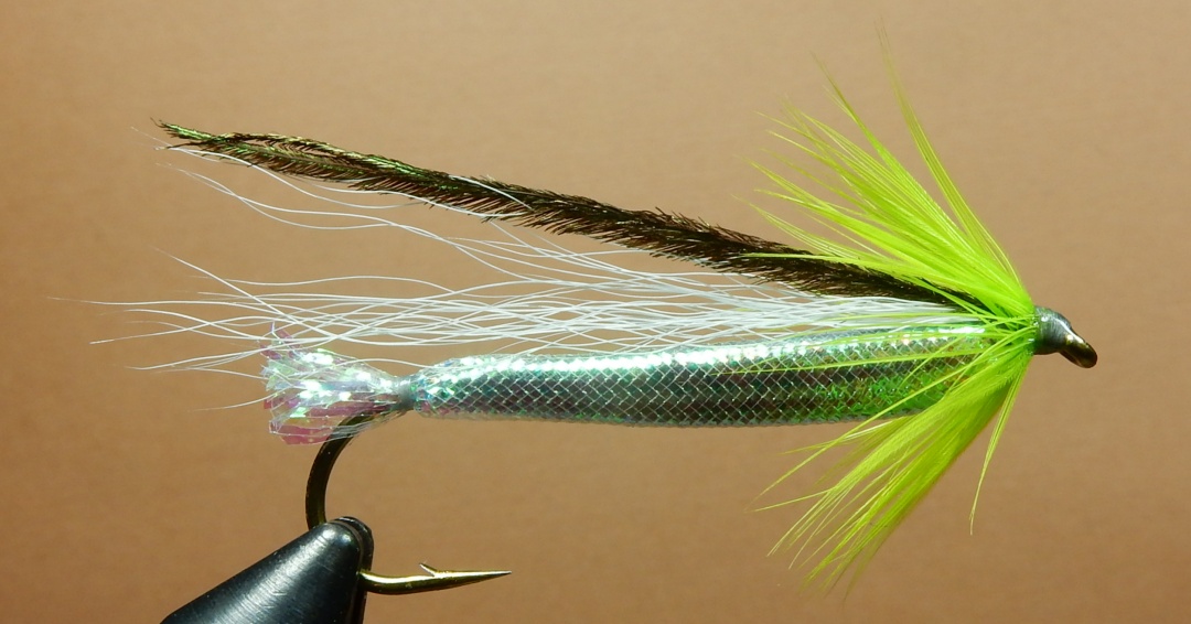

Post by nfrechet » Mon Nov 07, 2022 7:23 pm
Walleye Wrecker
Kevin Kirkelie
Hook - Long shank streamer hook, #4
Thread - Gray
Tail - Pearl mylar tubing (frayed from body)
Body - Pearl mylar tubing over shaped muffler tape or substitute
Wing - White bucktail then peacock herl
Collar - Chartreuse hackle
Notes: While walleye isn’t a common target for fly anglers, they will indeed come to the fly. These piscivores can be picked up on streamers and the combination of chartreuse and white can be quite a productive color combination.

It may be sacrilege, but I’m tempted to convert this to a tube fly. :o I’ve had good success with baitfish imitations as tube flies.
Muffler tape eh? That’s a new material for me to play with.
Beautiful baitfish imitation Norm.

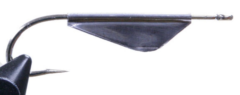

nfrechet
Posts: 970
Re: Walleye Wrecker
Post by nfrechet » Tue Nov 08, 2022 5:30 am
muffler tape is in the original recipe but i used metal tape cut to shape
similar to this
