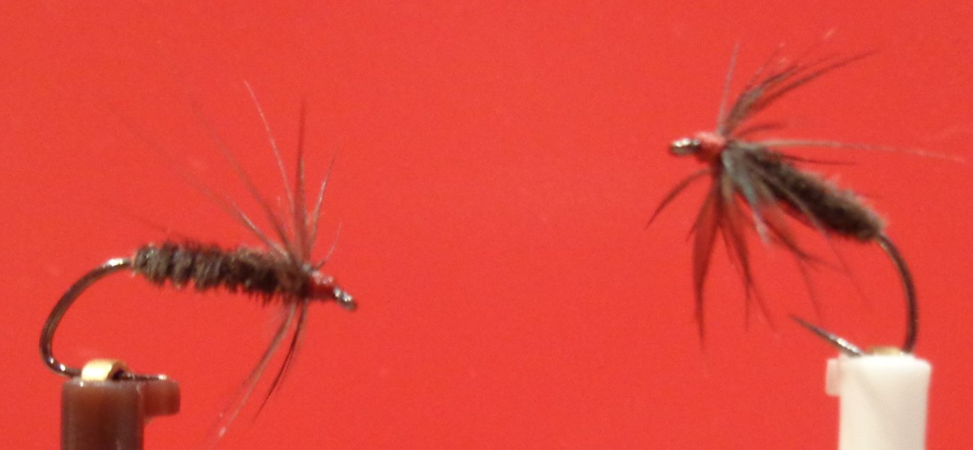

I picked up a pair of crow wings (Veniard) from Competitive Angler. Pulled 1 feather before sending them to the freezer. Of course, I could have just put them outside since today's high temp was 14 degrees. Quite the change from Monday when it was 74 degrees! That is 1 of the things that makes gardening in OK such a challenge, but I digress.
Took a shot at Leisenring's Black Gnat:
Hook: Maruto D82 - Size 14
Thread: Pearsall's Gossamer - Claret
Body: 3 fibers from a crow's secondary wing feather
Hackle: Purplish black feather from a Starling
Notes: I omitted the optional wing of dark Starling since the fly in the photo in the book didn't have a wing.
Kept the hackle short like the fly in the book photo (page 113).
For the fly on the left, I added a rib of 6X tippet material since those crow wing fibers seemed very fragile
(forgive me Forum Ghillie for I have sinned)!

Post by letumgo » Wed Feb 23, 2022 9:08 pm
Two thumbs up! The herl bodies are perfect. Very well done.
BTW - Those Maruto D8 hooks are new to me. Very cool. ;)

Post by FlyFisherMann1955 » Fri Feb 25, 2022 12:30 pm
Ray,
I thought the body would be darker since it uses a crow feather. When you look at the feather, it looks "black"; however, when you separate 3 fibers and wrap them around the hook, it's more of a "Gray Gnat". Perhaps that is why he lists the body material as black silk or 2-3 fibers from a crow feather.
Next, I will try ribbing 1 with XS black wire. Without a rib, I picture these herl bodies falling apart after you catch 1 fish!
