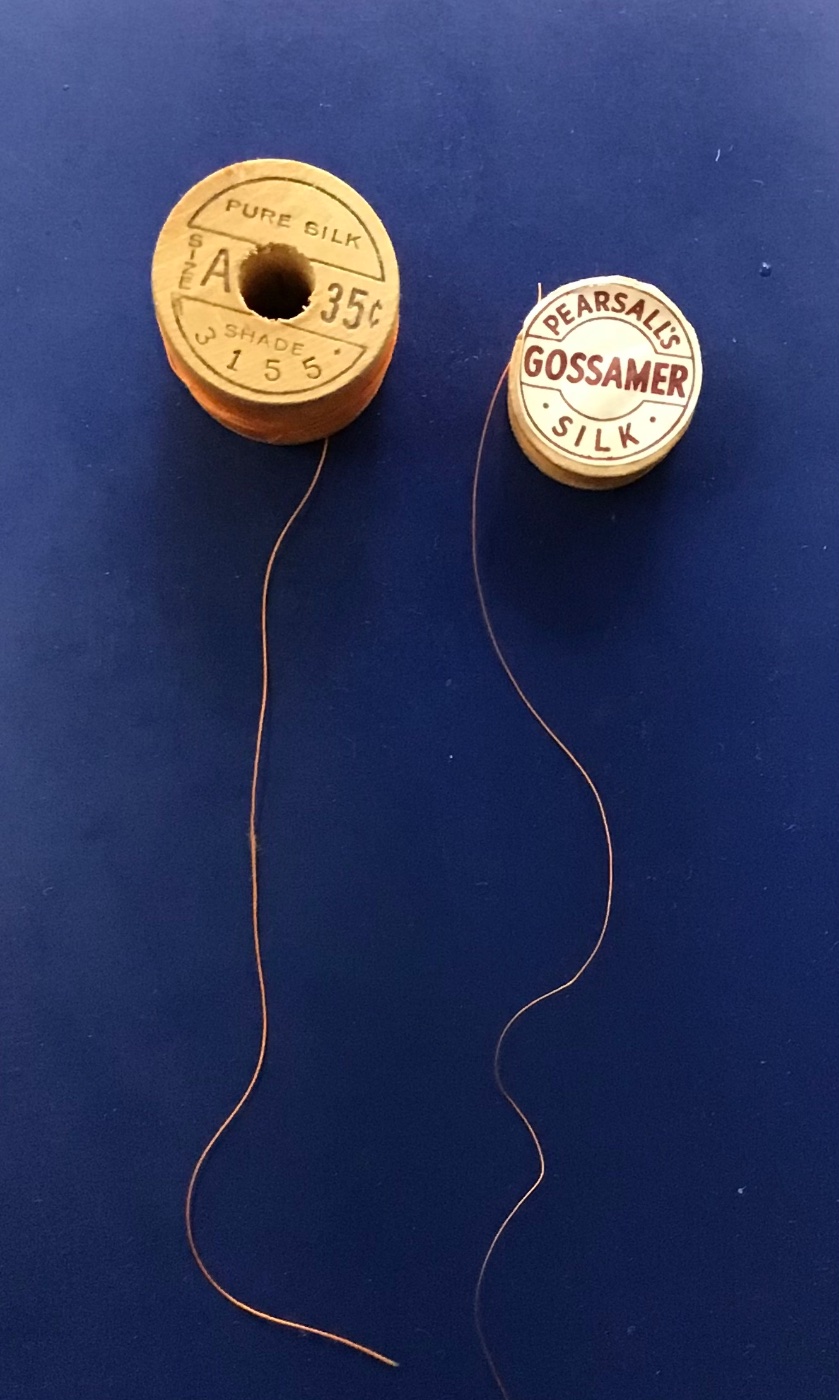

I agree gossamer is roughly 6/0. So would the Belding silk be bigger or smaller. Idk how how 0.17768mm compares without knowing what pearsalls or anything else measures

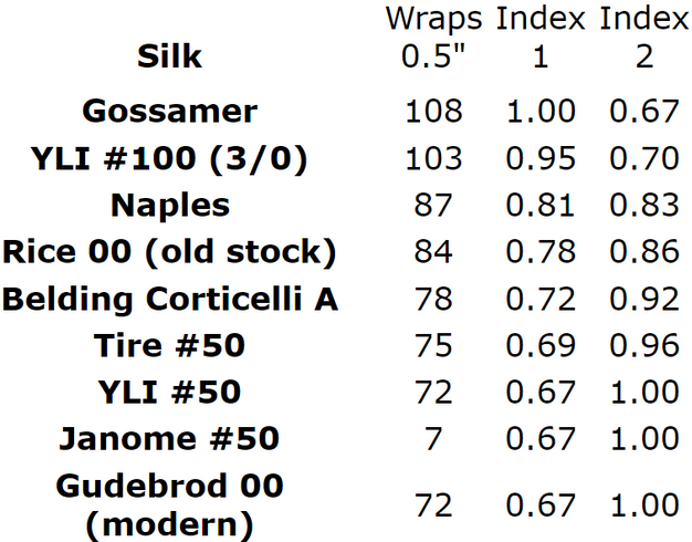

Terrestrial12 wrote: Fri Jul 15, 2022 12:02 pm Anybody have any experience with Belding Corticelli silks? Or how size "A" is in comparison to pearsalls or any other related ought or denier?
From cane rod builders here's a chart of how many wraps it takes to cover a given length with Pearsall's Gossamer and Naples in the mix. Remembering wrapping a rod doesn't include twisting the thread and that Kimono is a 2-strand whereas Pearsall's was 3-strand. The 2-strand types appear to obdurate{flatten out} quite a bit more than the 3-strand when not twisted. I've wrapped Kimono next to YLI in the 100wt version and get +/- 1 wrap per 100. When twisted I've found Kimono the same, or slightly smaller, than Pearsall's for diameter. Definitely stronger and without the annoying breaks/knots Gossamer has.
Chart has a misprint with the Janome being 72 not 7 as shown.
