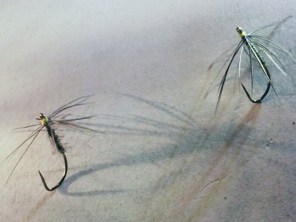

The Waterhen Bloah on the right was tied with the outer covert feather the left with an inner covert. The outer covert is darker and much easier to wind.
