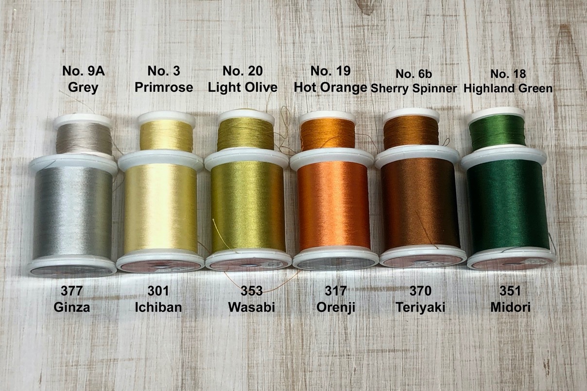

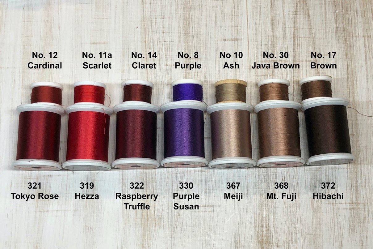

Post by Old Hat » Thu Jan 09, 2020 6:55 pm
Just some numbers I've worked out for Kimono and Pearsall's. There are also some other colors of Kimono that I really like that are not available in Pearsall's. I started tying with the Kimono when Pearsall's fell. I really like it. It is smaller in diameter to Pearsall's which is great for those #16-#20's. Mind you, my normal tying thread is Griffith's 14/0 so this feels very comfortable to me. I've had no breakage issues with the Kimono silk. It has some great colors that are damn close to Pearsall's. It's hard to photograph and compare side by side because the diameter difference does effect the photography. the biggest downside to the Kimono is the large spools. They won't fit a standard bobbin holder you will need to manipulate a large bobbin holder to make them fit. Anyway this may save some time if you want to try some.

I have made a lot of dubbing strands with it on a block. No difference at all. I prefer it now for smaller fly sizes. Plus when using a block to make dubbing ropes any slight color difference is really negated since most of it is covered by dubbing.

John, I have some of the YLI 330. Its very close. The YLI might be just a bit darker but it is hard to tell even with the naked eye on the spool because the fine diameter sits tighter and the sheen is more distinct.
