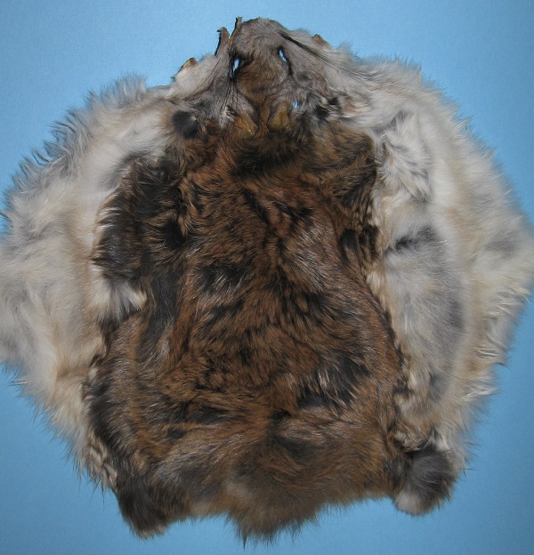

Water vole substitute. This is a kit muskrat skin. It's the only one I have ever seen this color. Ususally they are gray.
