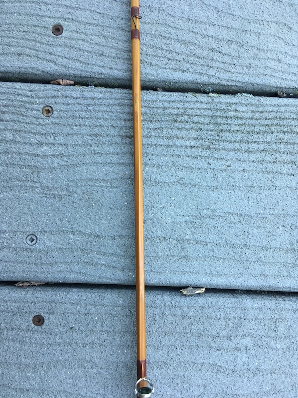

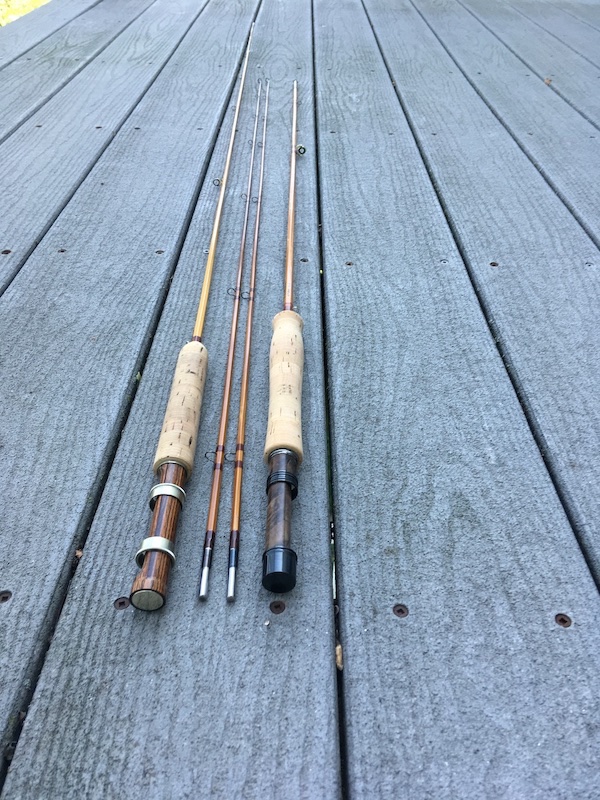

I guess it's no surprise that I fish bamboo for trout. Here's something a bit different, however. Both of these rods are spiral twist rods I built about 25 years ago. Spiral rods were invented and marketed by Fred Divine in the early 1900's, and a few have been built over the years by others as well. Basically you twist the rod 1/6 of a turn between each guide position, so the guide sits on the next flat over from the previous one, you can see that in the lower picture. This is done while the glue is wet.
The rod on the left is a one piece 5 1/2 foot brook trout rod which was built with a sister rod that was not twisted so people could feel the difference in performance. The other rod is a 7 foot Garrison 202 taper, which has a spiral butt section, a spiral tip, and also a straight tip. The straight tip bends easier, and produces a tip oriented dry fly type action. The spiral tip is stiffer, it bends the whole rod more, producing a slower, but more powerful wet fly action. I always found the spiral rods to be interesting and worth the effort, but they are trickier to finish out and take more time, making them unattractive to professionals, who need to get paid for their time.

Tom - This twisted design is altogether new to me. As an engineer, I find the design fascinating. Seems like an elegant way of distributing the stresses around the sections of the rod. Does the design make a difference in energy transfer to the line? A spiral design seems like it would naturally act as a “torsional spring” loading and unloading during the casting cycle. Have you noticed a difference in the casting behavior or feel of the rod?

Hi Ray - I built 15 spiral rods, always from tapers I had built before, and in a few cases, as matched sets with straight rods from the same cane, same glue, heat treated side by side, etc. In every case, the spiral rod would outcast the straight rod, no matter who was casting them. That was much to my surprise at first. That really should not be, as a rod section made as a regular polygon should be equally stiff in all directions. Deflection tests gave the spiral rods a slight advantage usually, but not always. Prestressing should not be a factor for long, as wood like material gradually deforms if held in a stressed position, relieving the stress over time. I think the factor is a dynamic one when casting. The only thing that makes sense is that the rod recovers faster when bent, producing greater line speed. I never had the equipment to test that however. I suspect that might come from reduced slippage in the glue bonds to the bamboo fibers, both the glue we use, and the natural lignin that nature provides, Maybe the twisting inhibits some slippage? I am still baffled, but the results are there.
You are right about the twist distributing inequalities equally around the shaft, if the rod is glued up straight, you will not notice a detectable strong side, and I do believe that makes to rod inherently more accurate.
