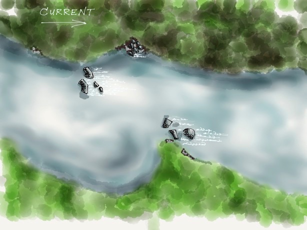

I am getting ready to form a presentation section on my website. Quick descriptions of wet fly presentations with a small diagram to accompany the description. I would be curious to note what general established presentations some of you may use and how you see them playing out on the water. I put together a quick background which I will use to place the presentation diagrams on. Here are the presentations I have compiled so far which are just some of the presentations I find myself using and the wet fly angler that I learned it from. I would be interested to know who might have first written description of some of them. Also if you use any of these, lets hear how you see them being used and what triggers might you see that would cause you to select a certain presentation. Do you have any others that should be added?

For fun here is a preliminary preview of the background I will be working off.
reduxPresentation Background.jpg (73.83 KiB) Viewed 24025 times

Just looking at your diagram, has me thinking about how I would approach this water, the structures, the currents, where the fish might likely be holding (and which direction them may be facing), exploring the depths, and how to methodically break it down. Where would I stand? How short or long my leader and tippet set-up should be. And what time of the season it is (may impact the depth the fish are holding, and what direction their attention is focused, from substrate (stream bottom) to surface.
