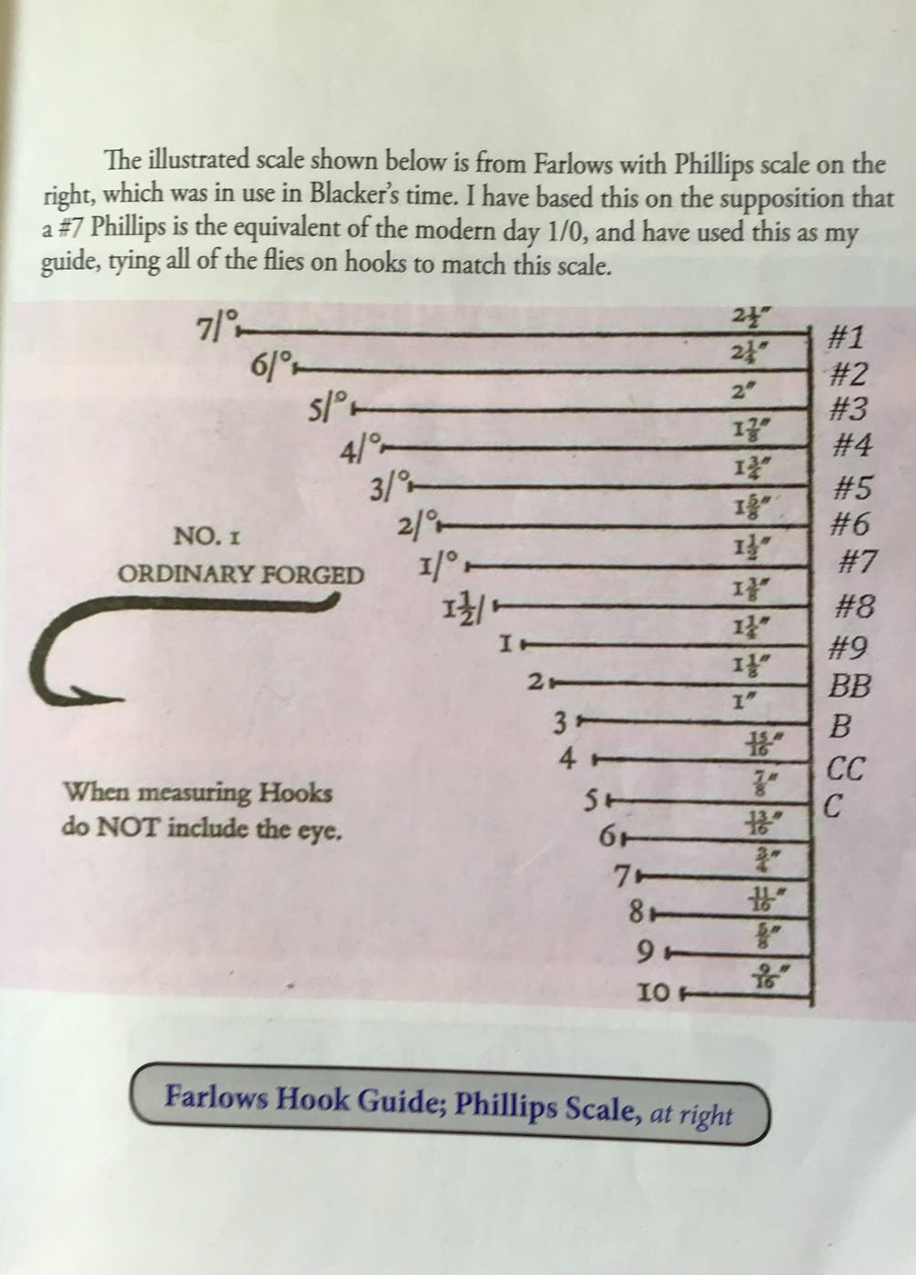

Can some one direct me to a reference or just tell me, what size, shape.etc. of hooks were "f", "ff", "fff", and "fe"? Book published in 1843.

What was the title of the book? I have quite a few 19th century titles at hand but would need to know the author, etc.
Trying to reference the older hook sizes can be problematic at best as there was no standard sizing. There really isn't any true standard sizing today, either. Then as now, each hook maker used their own sizing.
During the 19th century the first standard hook sizing sale was the "Reddich Scale", the scale we know with today, but many hook makers adopted what was called the "New Scale" which used single numbers like "1" and "2" for larger hooks with the smaller hooks being designated with "0" down to "000000". These numbers were very cumbersome for obvious reasons. The "New Scale" sizes were often listed with reference to the "Old" or "Redditch" Scale because everyone was still familiar with it. The "New Scale" persisted into the 20th century when everyone went back to the "Old Scale"!
Many of the older books have printed hook charts that you can lay a hook on to size it but this can be a guessing game as well. Remember that older hooks were often smaller size for size than modern hooks, especially when compared with Mustad hooks.
One of the best and most lucid discussions of hook sizing is in Datus Proper's "What the Trout Said".
The very best advice I have is not to get too concerned with old hook sizes and tie on the sizes that work best for your fishing conditions.

I was attracted by the title. Catechism of Fly Making Angling and Dyeing https://archive.org/details/wblackersar ... 8/mode/2up by William Blacker (1843 edition – 130 pages)

This is fascinating stuff! John, that's the name I was looking for, "Reddich" scale! Thank you!
Bill, also quite interesting how the lengths (less the hook eye) were equated to numbers! Yea, I can see myself fouling this up rather quickly!

I took the picture of the hook sizes in this book:
