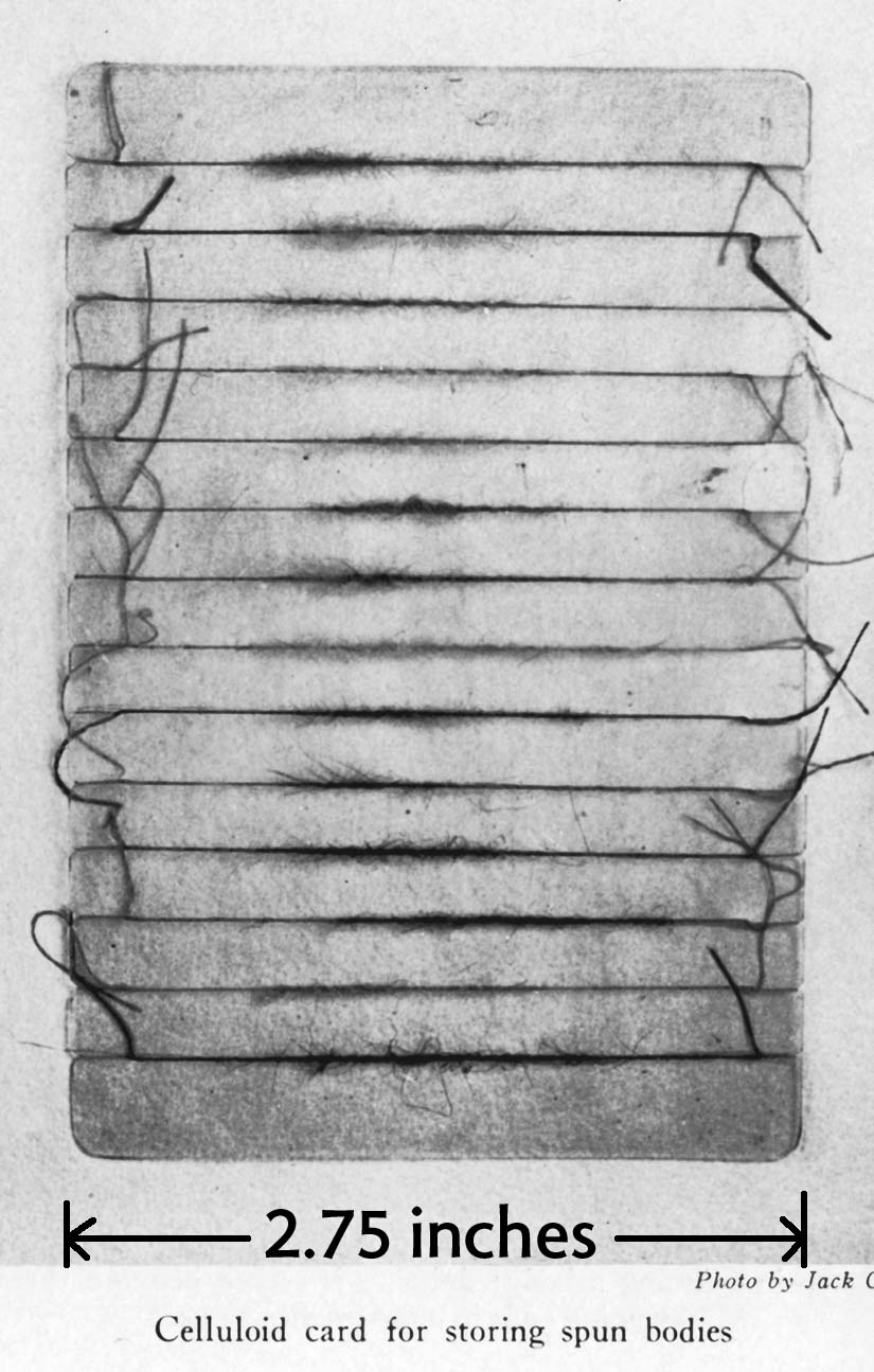

Here is a scan from ART OF TYING THE WET FLY, 1941, showing how delicate and tapered Leisenring's dubbed bodies were. Like Roadkill says, these were dubbed on the leg of his pants. Most people today are dubbing their bodies much heavier, which, judging from this photo, Leisenring would not approve.
The dubbing block was not a Hidy contribution. It came from a fishing and fly-tying companion of Leisenring and Hidy named Richard G. Clark. Hidy preferred using the Clark Spinning Block, but, he used it pretty much the same as when he spun bodies on his leg. I learned this from someone who met Hidy and saw him do it.
There was an article about Clark's spinning block in the bulletin of the Anglers' Club of New York, Vol. 47, No. 3, Oct. 1968, published a few months after he died.
- Scanned from the first edition of ART OF TYING THE WET FLY, 1941, by Leisenring and Hidy.
