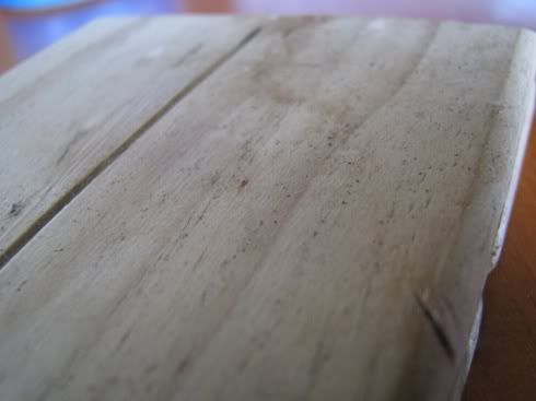

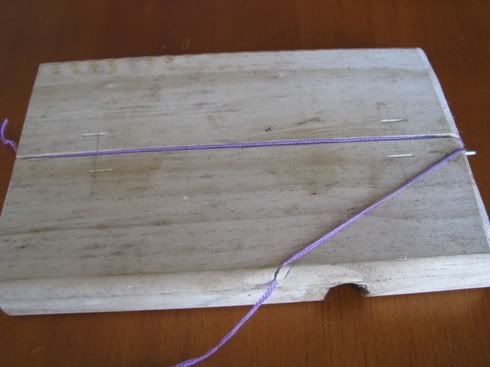

The main reason behind this post was to show that even with limited means and materials the Clark block is not out of reach for anyone capable of tying a fly. The block need not be from some exotic hardwood or finished to a gloss you can see yourself in.
I searched and found very little on the internet in regard to making or sizing of blocks and a lot of what I did find was for mechanical spinners and big flies, not really suited to flymph tying. So I decided in good old Kiwi fashion to have a go at making one. This was to be an "experiment", if it worked then more time, material and expense could be spared in making a block that whilst looking better may not work any better!

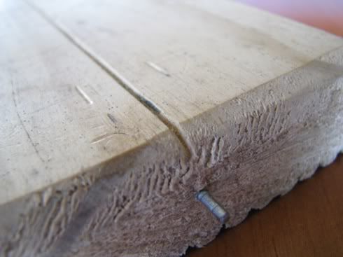

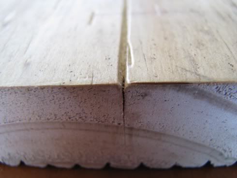

The block pictured below is made from scrap pine decking, 5.5 X 4 X 3/4". The groove in the middle was formed by a marking gauge and an exacto knife used to make the thread holding slits at the bottom and right side. The top edge is rounded over by a hand plane, then a small finishing nail was driven below and inline with the top groove. Head cut from the nail with pliers and then filed/ sanded smooth so as not to catch and/ or cut the thread.
Close ups of nail, groove and knife cuts. (note* no sandpaper used here! :lol: )

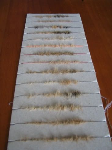

Which has led to my first attempts at making bodies. Again on the "cheap" with craft store embroidery cotton, paste boot wax and self harvested Hare mask.

Try using a paper glue stick instead of wax. This washes out when the fly is fished, but it holds together much better than wax on the dubbing block. You can also use this for "touch" dubbing.One like this for instance;
