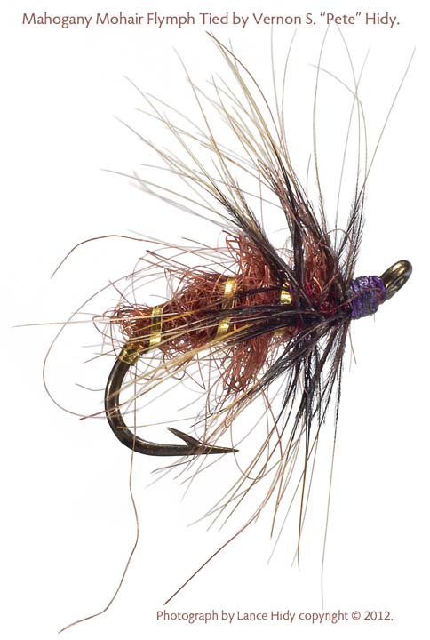

Gunnar's 5 mm dubbing length rule is probably a good rule of thumb. But like all rules, it is meant to be broken. I have looked at many of the dubbed bodies that Pete Hidy made and stored on notched cards. There is no consistency to the length of dubbing fur he used. For one thing, he varied the length according to the size hook he intended to use. I wouldn't be surprised if Gunnar did as well. In his later years, Pete Hidy tied a lot of mohair bodies that are very long and unruly. I will attach a fly tied with one of them. A lot of other Hidy spun bodies have some long strands and spiky hare's face guard hairs mixed in with shorter cuttings.
Hidy and Leisenring both used dyed yarn and worsted wool as a source of fibers. They would carefully disengage the long wool or mohair fibers from the yarn. Hidy sometimes would stuff the little nests of full-length dyed wool fibers into little plastic bags for future sessions at the Clark Spinning Block. He would wait until the dubbing session to decide what length to cut the wool, which would then often be mixed in with mole, muskrat, opossum, hare, seal, etc. He blended the fur the slow way, with his fingers and tweezers.
- HidyMahagonyFlymph.jpg (69.06 KiB) Viewed 124133 times

Oh yeah - that's a fly to my liking. Scruffy!! Something exploding in the water. Myself, I'm not tidy but it can be beautiful in it's own right. "Art for art's sake..."

Lance - this makes me want to go immediately to my vice to tye some of these flies. Wonderful stuff. I am a big fan of wool dubbing. The course texture of natural wool creates very "buggy" bodies.
Stefan - I agree. There is something asthetically pleasing about the messiness of the bodies of flies dubbed this way. Wild, like Nature herself.

As for Roadkill's sage observations on fly dressings, I have this to say. What I am seeing in Pete Hidy's collection is the full spectrum from relatively realistic and traditional patterns, to others that are more inventive and ambiguous—like this flamboyant mahogany flymph that I posted earlier. It is safe to say that Pete agreed with Jim Leisenring that it was absolutely essential to study the appearance of the living insect to match its essential qualities. But their idea of a realistic fly was very different from what goes today as "realistic". Anatomical details were not as important as general color, profile, translucency, etc. and of course, proper presentation. Although Pete and Gunnar were both intense fly-tyers, both agreed, as Gunnar once put it, that the "driver is more important than the fly."
