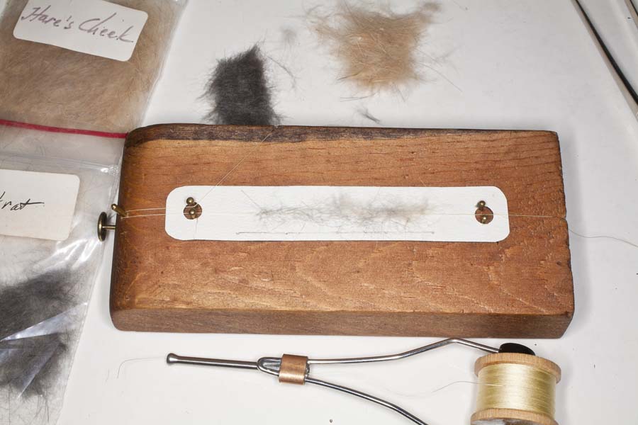

I imagine one could use any textured material for the "sighter" pad as the idea behind it would be to help stop the dubbing adhere to any remnant wax as much as being the background of contrast?
So the brass nails are fairly self explanatory, bu what is the chrome eschunion or upolstory pin for in the top of the block?
Personally, I find that the smooth white background is fine, even for the more transparent dubbing fibers. The black Naugahide on the other side has a rough fake leather texture that I find interferes with seeing the fine texture of the dubbing. I never use the black side. Perhaps a white stain on a light poplar or pine block would be good.
Now getting down to brass tacks :D I am not sure how Pete used that big one on the end of the block. He may have looped the thread around it to measure two block-lengths of thread, which would have been roughly 10". I find that 11" is a better length, and then I trim off the extra after the finished body is notched securely in the card. That extra inch makes it easier for me to spin the loop after the dubbing has been applied on the thread. You can't see it in my photo, but on the other end, on the bottom, Pete cut out an area for inserting a half-inch razor blade to cut the thread lengths. IMHO, that is a lot of trouble for not much advantage.

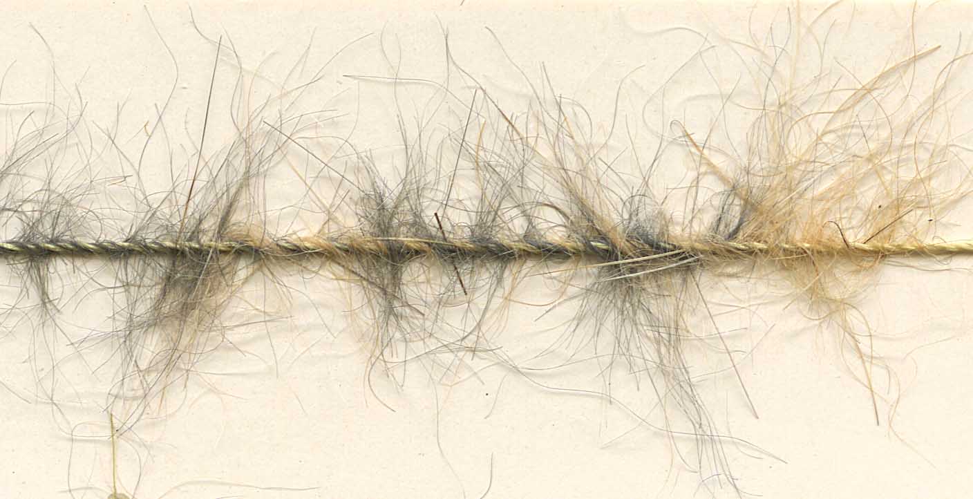

Your photos of dubbing cards made me realize I can create some that are a lot sparser then anything I've created so far.
Wayenb, Yes some are amazingly sparse, but others not. He had a full spectrum for all sizes of hooks and patterns. But in general, they tend to be sparse, to make slender bodies, like the little bugs bodies. And he often tapered them, more slender at the tail, and thicker at the head. He didn't like the double-taper that got thinner at both ends. Neither did Leisenring.

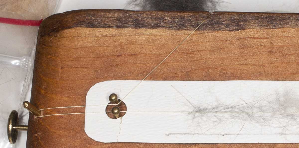

OK, here are some more shots to explain how Pete Hidy used the Clark Spinning Block.

Lay the other half of the silk over your carfully-placed dubbing and secure it in the notch with the other end of the thread. Note the little cutting blade that Pete inset into end of the block for cutting thread to the correct length.

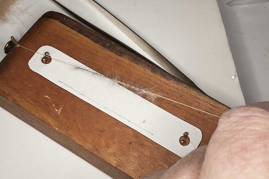

Lift both ends together and start spinning to make a little rope. I moisten my fingers to get some friction on the thread. Only twist in one direction. Twist so you have tight winds all through the dubbing.

Here's the finished body, in detail. I blended the Hare's cheek and Muskrat right on the block, not in advance.
ABOUT THE WAX. Leisenring gives the recipe in Art of Tying the Wet Fly, page 8. He says it is an old recipe of J. Harrington Keene. In brief, the ingredients are one-half pound of the best white turpentine resin, one ounce of pure white beeswax, and one-half ounce of fresh lard. He would cut off pieces the size of BB shot. Pete would warm the wax up in his fingers, and soften it before sliding the Pearsall's silk through it. This would make the thread just a little tacky, enough to keep the dubbing from sliding, but not enough for the fibers to stick to it.
As I said before, silk is the best for these dubbing loops, because it will set overnight, and not un-twist when you remove it from the card to tie into the fly. Other threads don't hold the twist so well, even when waxed, and tend to unwind even days later.
I used to try to make my dubbing look more perfect, but now I like it to be a little unruly, with gaps and different length fibers. Looks buggier.

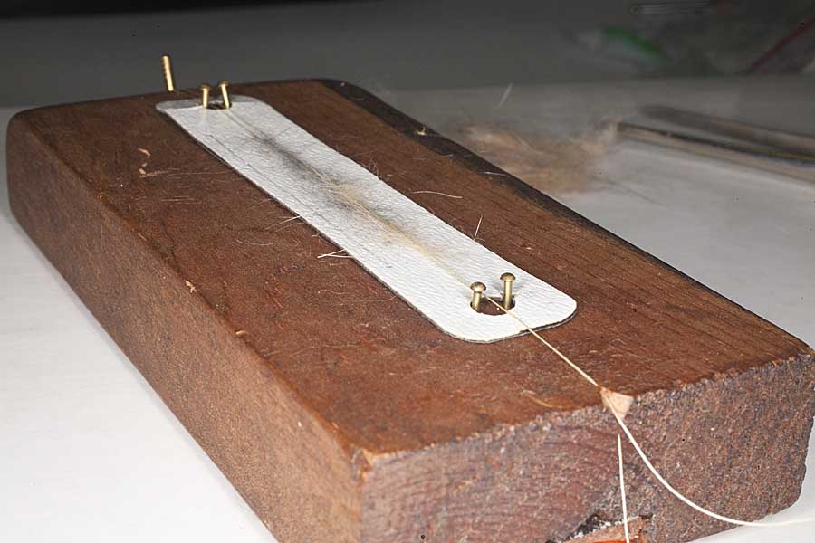

In my dubbing block I have placed the brass nail where Pete has his big one. I have then made a notch in the exact center of the rounded end. This way the thread gets perfectly aligned and stays put in the notches in opposite ends. This also makes it easy to put the thread over the dubbing and lock it in both notches prior to starting spinning the silk

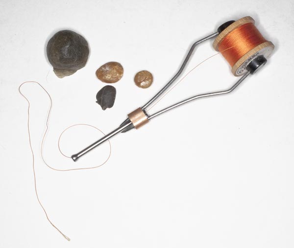

Anders Forsling, Gunnar's co-author ("Flymfer"), used the block with the silk on the bobbin holder. He put a piece of rubber tubing on the bobbin tube and made a notch in the rubber. When the dubbing was in place, he put the loose end of silk into that notch and twisted the bobbin holder hanging down from the block before he gently lifted it to let that twist run to the nail in the other end.
