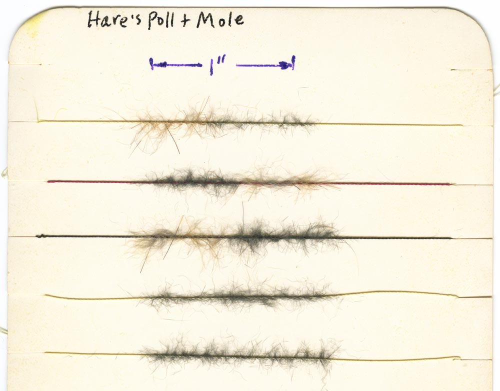

Leisenring and Hidy maintained that there were some advantages, however, from their old-fashioned point of view. They said the spun body was tough, and would last longer, standing up to the gnawing of the trout teeth. They also liked to have a variety of sizes and colors on store for an emergency match-the-hatch situation. And when they went to the trouble of preparing a special dubbing cut or blend, they liked to quickly tie a card or two of bodies for future use, which went faster than tying the flies.
For myself, I actually enjoy the whole process of making the spun bodies. It is just another part of the craft, which when done well, gives me a good feeling—especially since it involves so many little decisions at each step. Takes a lot of practice to get it right.
About the wax, like Leisenring and Hidy I just use the hard wax that I soften between my fingers, not very sticky at all. Doesn't need to be, since when you lay the dubbing on the thread, it isn't going anywhere.
I know Jim Slattery is a purist, spinning the bodies Leisenring-style, on his pants leg. But one reason Pete Hidy liked the spinning block was that he could put it conveniently on the table, maybe on a thick book to raise it up. Ergonomically this is better, since you don't have to bend over as far to inspect the dubbing while you are carefully depositing the tiny clumps of cut fur, one tweezer-tip batch at a time, on the single strand of silk. I would estimate that it took about six or seven tweezer-batches to apply enough dubbing for the first body on the card below.
After a half hour the twisted thread has set enough so you can safely remove the body from the card for tying. It will untwist some, but not enough to release the dubbing. I re-twist it after tying it to the hook, near the bend. If you set the body overnight, it holds the twist better when you remove it from the card, so long as you use silk. Other kinds of thread don't set as well as silk does.

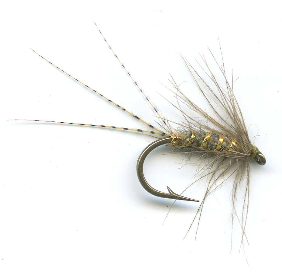

Here is a card with some bodies I tied in December, with size 18 hooks in mind. And a fly I tied this morning with the first body on the card.
Hook; 18 wide gape, maker unknown
Thread: Amber Pearsall's gossamer silk
Hackle: Ashy hen with ginger tips
Body: Hare's poll and mole on Primrose silk
Tail: Lemon wood duck
Rib: Fine gold tinsel
- These were made on the Clark Spinning Block.
- SmallBodiesLo.jpg (85.92 KiB) Viewed 6619 times

Oh my goodness! That is an absolutely gorgeous fly, G'dun.
Re: Clark's dubbing block
Very interesting thoughts Gingerdun, and I loved the photos too!
