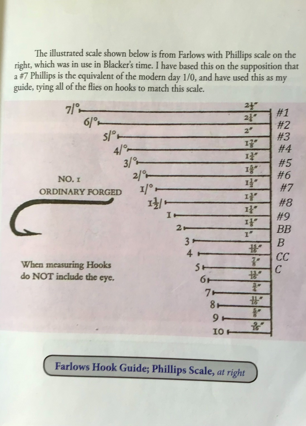

This is fascinating stuff! John, that's the name I was looking for, "Reddich" scale! Thank you!
Bill, also quite interesting how the lengths (less the hook eye) were equated to numbers! Yea, I can see myself fouling this up rather quickly!

I took the picture of the hook sizes in this book:
https://www.anglebooks.com/catalog/prod ... w/id/47888
