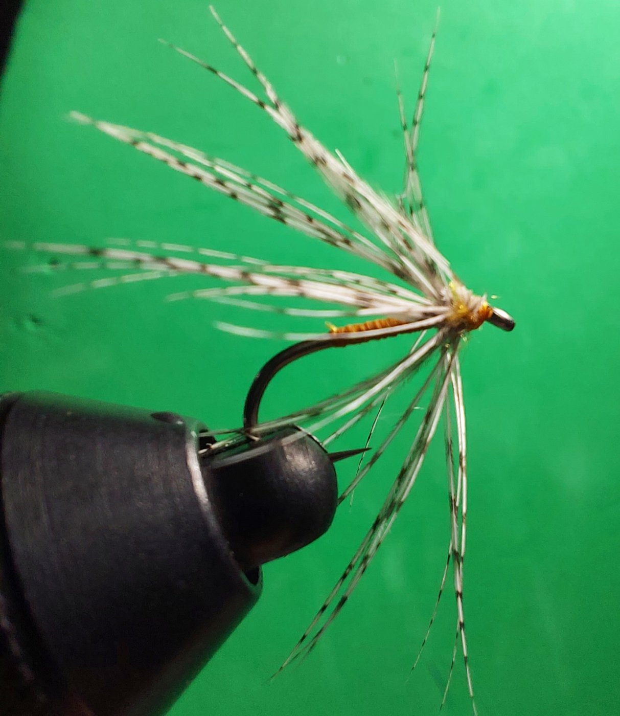

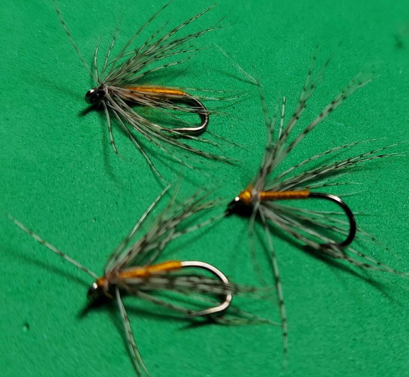

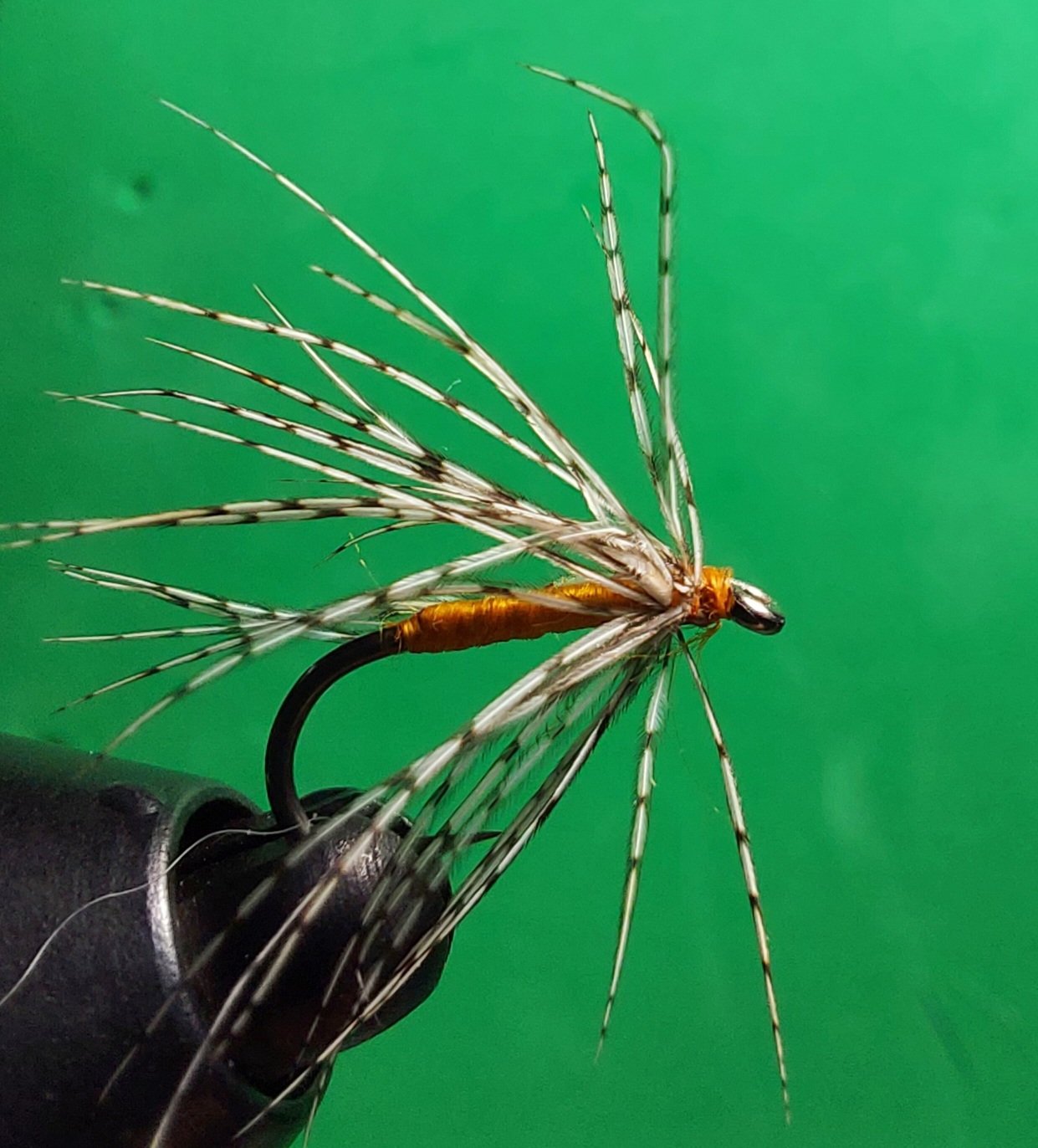

Comparison, as promised. The front two have silk floss wrapped and tied off and then 8/0 uni thread to tie on hackle. The rear one is with Pearsall's silk. All on size 12 GCO heavy wet fly hook.

Floss body top. Silk thread bottom.
The floss likes to fray. Has to be tied in and tied off. Not worth the trouble to me.
