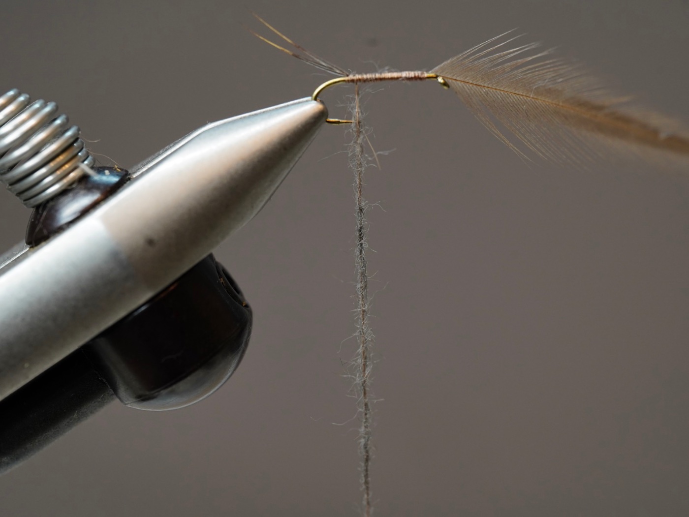

I've started playing with a new (to me anyway) method of flymph body construction. It has been good for making mottled patterns in the bodies as opposed to a solid mix of colors. Still working on it but here is the basics.
Tied with a drop loop rope.
I add a small amount of dubbing to the hanging thread. Small fibered fine textured dubbing is best. Here I am using mole.

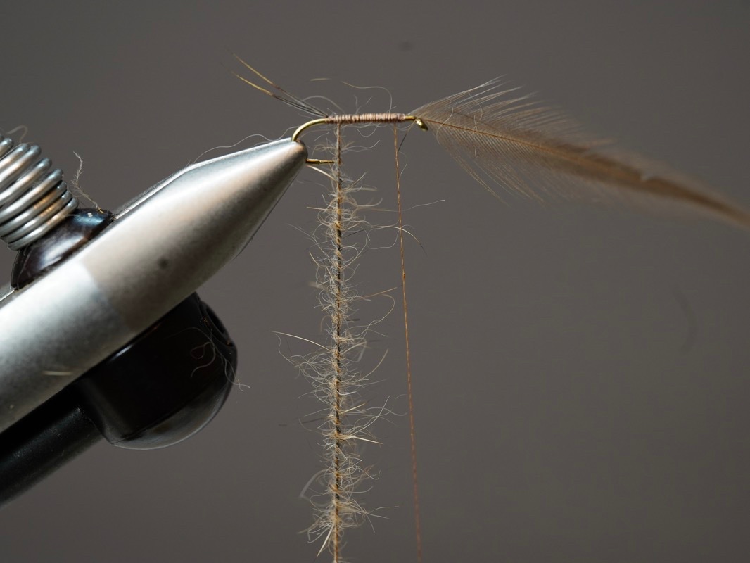

I then form the loop and slip in some stronger textured, longer fibered dubbing at a 90 degree angle to the thread. Here I have use hare's poll. Again, keeping it sparse. Very easy to get too much dubbing in the rope.

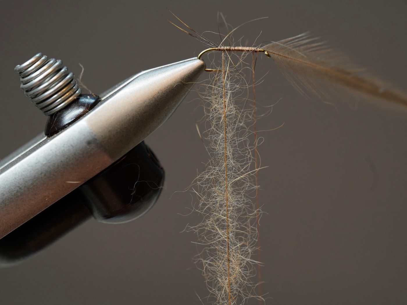

Spin the loop up and you see you get a nice banded rope of the two different dubbings.

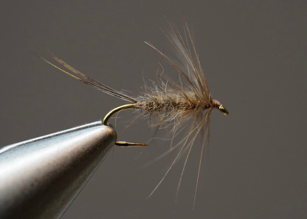

A pretty neat mottled effect for the dubbing (think dubbed jasper silk) I still want to play with some color combinations and more material mixes.
