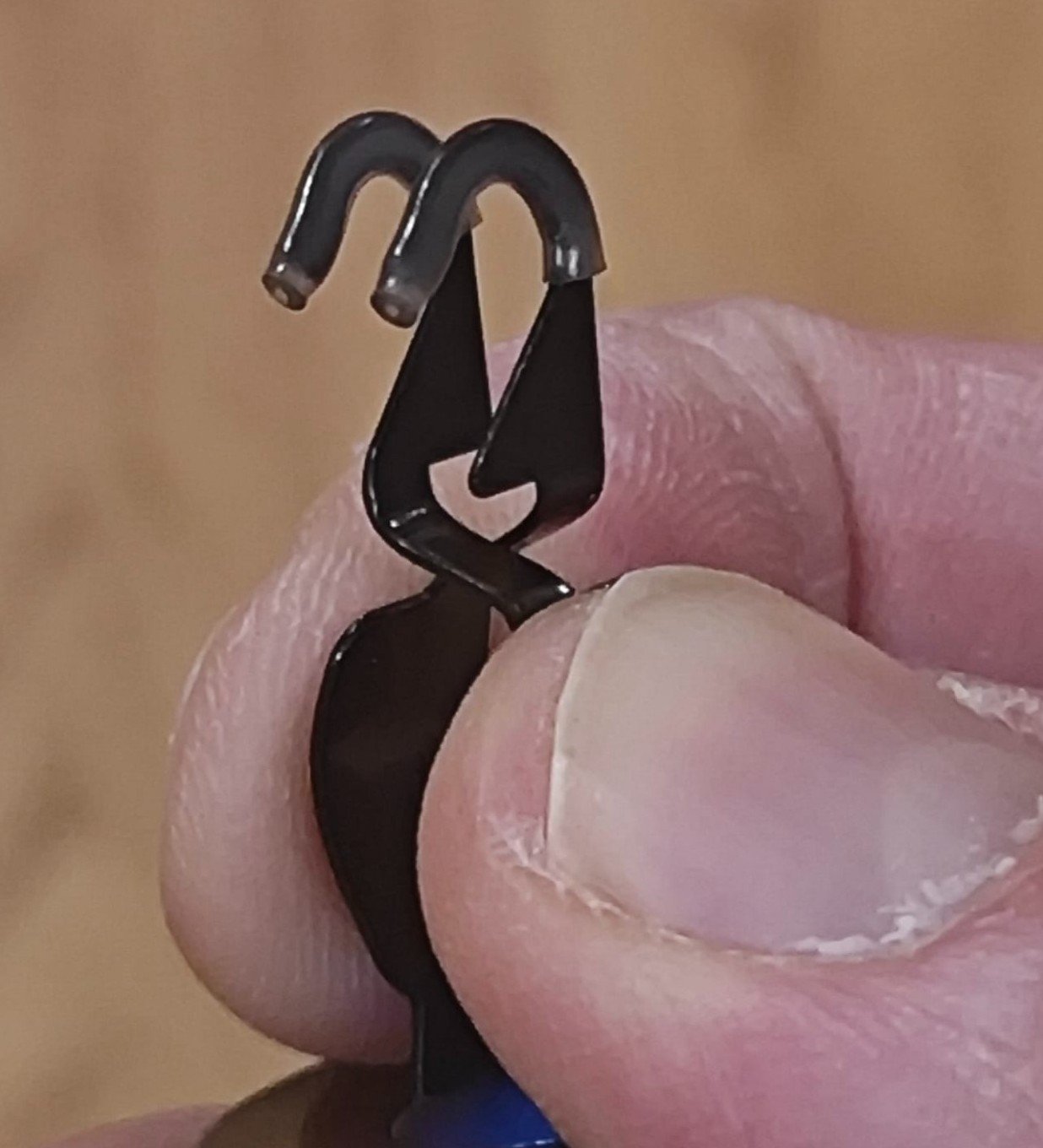

Partsman, I had the exact same email conversation with probably the same guy, just last week. He's apparently very aware of the issue. Here's the pic he sent me of the "Finnish" (customer from Finland) shrink tube solution
shrink tube~2.jpg (130.79 KiB) Viewed 119354 times
I'm away traveling at the moment, but another thought I had was to wrap some GSP thread around each hook arm. Might slip off or bunch up over time, though.
I tried 400 grit and it worked only somewhat....
Ray, did you give it a heavy or light-touch-only sanding with the 1500? You're the Batman to this Gotham city!!

Yup, same picture, I sanded some today very lightly, and the I hit with some rogue on a Dremel polishing wheel. It helped some but still popped the thread once. My local hardware did not have small enough shrink tube so I’ll still have look around a bit for that, or I thought about liquid electrical tape or plastic dip all available at Ace hardware. I’ll figure it out eventually :lol:.

chugbug - I sanded it pretty hard. Inside and out. Sanded until I could not feel and rough edges when rubbing my fingers over the edges. The tool works as designed, once properly sanded.
