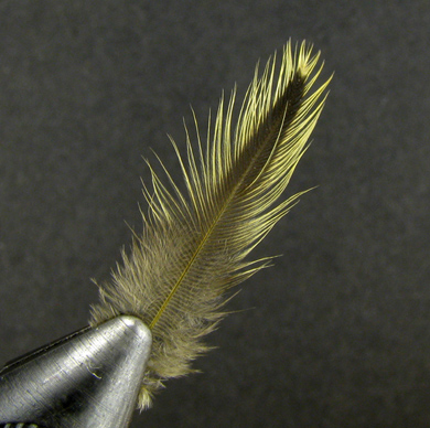

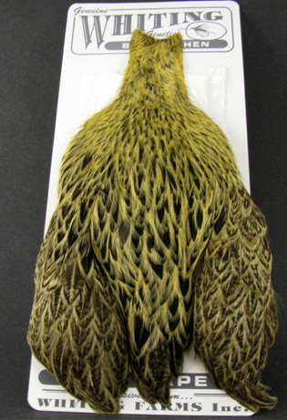

Saddle feathers are more like partridge feathers, more rounded and softer, more striations in the color pattern
LINK
Cape Feathers are more like tradition hen capes. Longer, thinner fibers and thicker stems (the cape is the center feathers, this particular cape came with some saddle feathers on the sides)
Single Feather
Both are good feathers types to use. I am really fond of the saddle feathers though, love the color patterns on them.

Hey Bill.
The only difference I can tell is that the Chickaboo patch is included with the cape. I have both and the feathers are identical other than the missing rump patch on the cape. As RnF points out, there are differences in shape between saddle patches (hen back), Indian Hen backs, and full capes. The samples I have are both capes; one with and one without the rump patch of chickaboo. Those feathers are the same shape, just minus the patch.
Best,
Bruce
