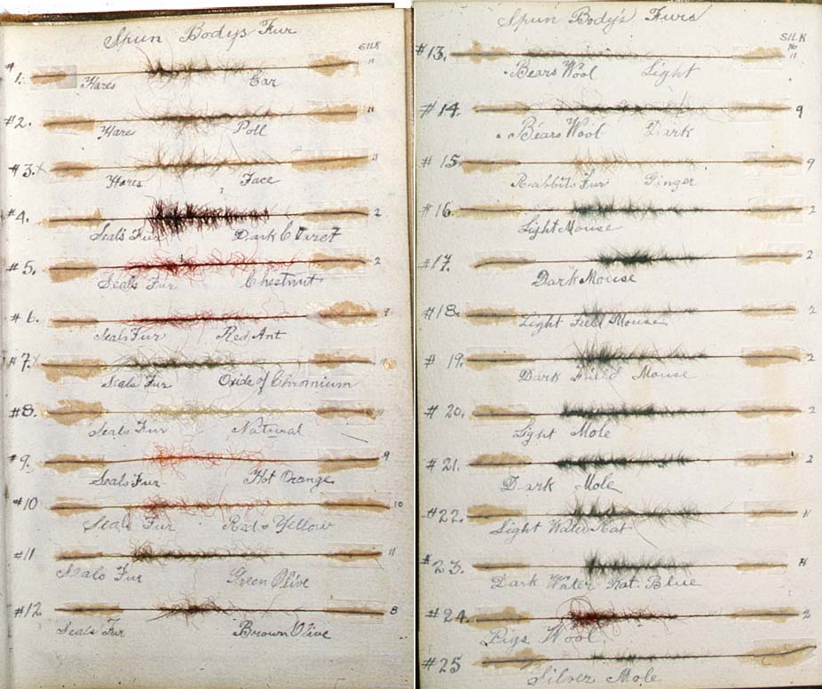

Rurad, Could you explain more? What are "slides"? Do you mean a shallow, rounded groove in the wood block for the silk and dubbing to settle into? Pete had some blocks like that, and that was what Dick Clark recommended. But Pete abandoned the groove eventually, using a flat pine block, laying very small amounts of dubbing in small increments across the waxed silk.Ruard wrote:The most difficult thing when using a dubbingblock is in my opinion: spread the dubbing as evenly as you can. When using silk as a thread make some of the boards with slides in it.
Greeting
I'm attaching examples of how Big Jim spun them on his pant leg—which Dick Clark and Pete replicated on the block. Some people think that the pant leg method is superior, but Pete did not think there was a significant difference.
These photographs were made by Gunnar Johnson, and appeared in his 1989 book FLYMFER.
- BigJimBodies.jpg (129.22 KiB) Viewed 9832 times

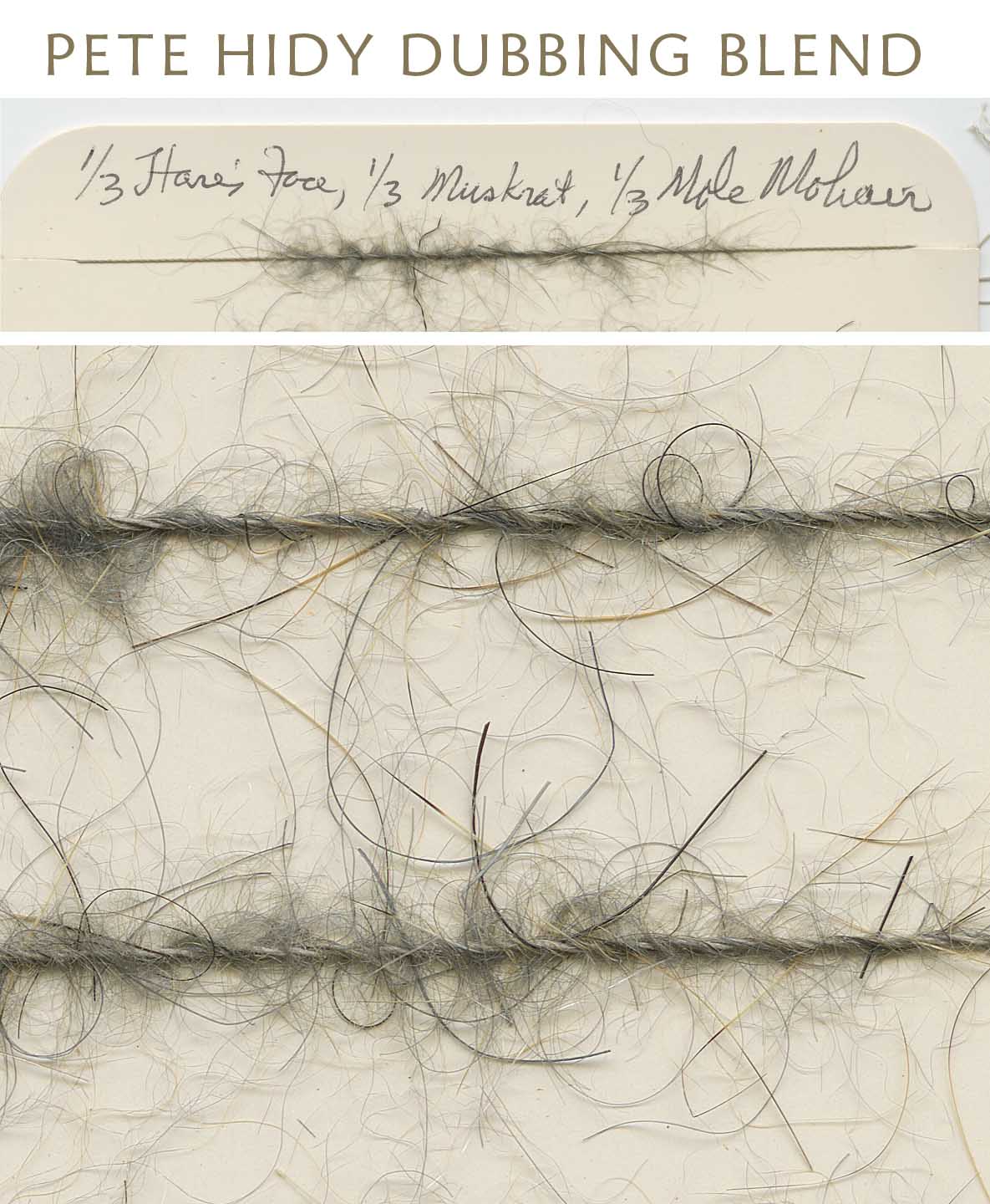

While I'm at it, here is a close-up example of one of Pete's blends, noted in his handwriting on the card—Hare's Face, Muskrat, and Mole Mohair. He was blending textures rather than colors. Done on the Clark Spinning Block.
The silk is his favorite Pearsall's Gossamer Ash, now discontinued.
- PeteDubBlend.jpg (163.16 KiB) Viewed 9838 times
