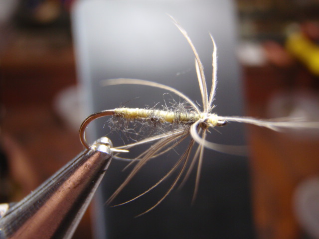

Post by John Dunn » Mon Feb 23, 2009 3:34 pm
I'M going to post a picture ?
This was the body I was looking for.
John
Fly 012.jpg (72.69 KiB) Viewed 15480 times
"The trout do not rise in the cemetery, so you better do your fishing while you are still able." - Sparse Grey Hackle

Post by Soft-hackle » Mon Feb 23, 2009 6:45 pm
John,
Have you tried splitting the thread. Untwist it by spinning the bobbin in a clockwise direction. Carefully split with a pin or needle. I hold it apart with my non tying hand forefinger, place a little fine dubbing between the fibers, then re-twist and wrap.
On the Double Olive Flymph, I dubbed Leisenring fashion.
Thanks to Hans and Aaron for the tips in the other forum ;)
Mark
http://www.libstudio.com/FS&S

Post by John Dunn » Tue Feb 24, 2009 6:45 pm
I thought I would post this just in case the thread was read in the future. I solved the problem with the dub by using a glue stack. The wax was not sticky enough ,with the glue stack the mole hair stuck to the silk thread and wrapped quite fine on the body of the hook. IMHO it looked better than the above picture.
Regards
John :oops:
