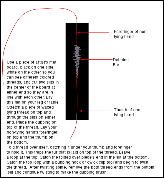

Here is a sketch that Mark (Soft-hackle) created to help explain the Leisenring dubbing method. You can think of it as a silk dubbing brush.
The following text was written by Mark. I am just copying it here to help answer your question.

Thanks for posting that info, Ray. Here's a link to those instructions with illustrations.
http://www.libstudio.com/Leisenring
A Clark's dubbing block can also be used for a similar result.

The thanks should go entirely to Mark. I was just reposting his excellent description and drawing.
