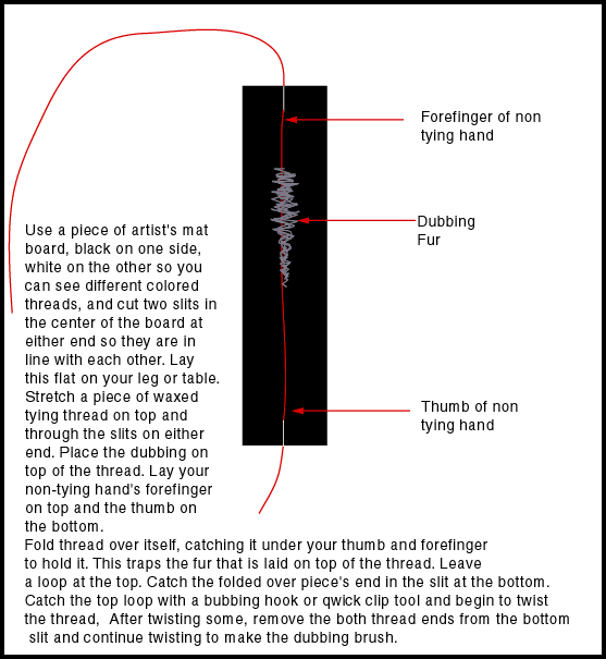

Here is a sketch that Mark (Soft-hackle) created to help explain the Leisenring dubbing method. You can think of it as a silk dubbing brush.

Thanks for posting that info, Ray. Here's a link to those instructions with illustrations.
http://www.libstudio.com/Leisenring
A Clark's dubbing block can also be used for a similar result.

The thanks should go entirely to Mark. I was just reposting his excellent description and drawing.
Mark - You may want to pin this post some where on the site. This question seems to come up fairly regularly.
