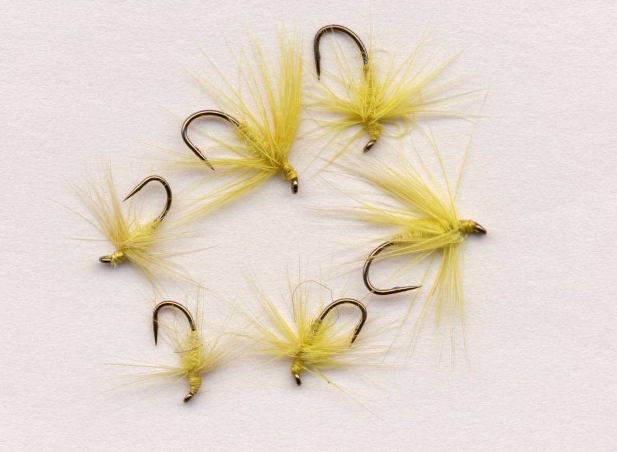

In the Oliver Edwards video where he ties North Country Spiders, he does a Yellow Spider dressing that I really like. Here's a pic of my feeble attempts at doing Mr. Edwards' Yellow Spider.
Hook: Daiichi 1550 size 14
Body / Thread: Pearsall yellow silk
Hackle: WHite hen hackle dyed in turmeric

Many of us have fallen short in attempts to copy the talented Mr. Edwards, but your yellow spiders are a mighty fine effort.

I forgot to mention that the yellow hackles were actually white hackles dyed in a Turmeric, water & white vinegar solution (which I also use to dye gray / dun hackles into various shades of olive).

Lovely spiders, and thank you for adding the comments about dying the hackle. Nice to see the results, and be inspired to try this myself.

Wow! That dye bath really came out well.

I take an old jelly / jam jar, add some turmeric, maybe a tablespoon full (approx.), fill the jar 2/3 of the way up with warm water, then add a couple drops of white vinegar. Put the lid on the jar, shake the jar to dissolve the turmeric and then add the hackles.
I leave the hackles to soak for a couple hours, then drain the jar and keep adding clean water until all the yellownsoultion is out of the jar.
When wet, the hackles stick together, so I separate them and place them on a paper towel to dry. Once dried, I fluff them up (back and forth on the stem) to get them back to their original shape.
Some interesting hackles can be made with turmeric. Light tipped starling then look a little like Golden Plover. Grizzly whites become a yellow Grizzly, etc. As mentioned previously, grays become various shades of olive.
